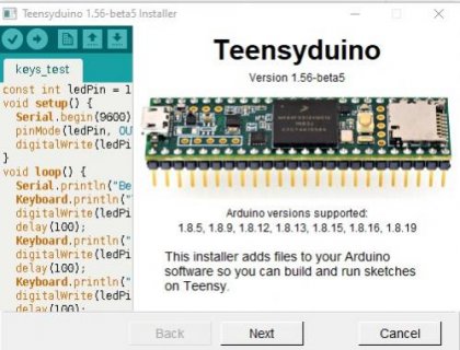

Here is a fifth beta test for Teensyduino 1.56.
Linux 32 bit:
https://www.pjrc.com/teensy/td_156-beta5/TeensyduinoInstall.linux32
Linux 64 bit:
https://www.pjrc.com/teensy/td_156-beta5/TeensyduinoInstall.linux64
Linux ARM:
https://www.pjrc.com/teensy/td_156-beta5/TeensyduinoInstall.linuxarm
Linux ARM64:
https://www.pjrc.com/teensy/td_156-beta5/TeensyduinoInstall.linuxaarch64
MacOS 10.10 to 12.x:
https://www.pjrc.com/teensy/td_156-beta5/Teensyduino_MacOS_Catalina.zip
MacOS 10.7 to 10.14:
https://www.pjrc.com/teensy/td_156-beta5/TeensyduinoInstall.dmg
Windows:
https://www.pjrc.com/teensy/td_156-beta5/TeensyduinoInstall.exe
Changes since Teensyduino 1.56-beta4:
Support for Arduino 1.8.19
Drop Arduino 1.8.18
SdFat use same SDIO signal strength on all Teensy 4 (mjs513)
More MicroMod & Teensy 4 pin 38 & 39 fixes
Fix AudioPlayQueue internal stall (h4yn0nnym0u5e)
Add AudioControlCS42448 functions (modularev)
AudioInputAnalog compile on Teensy LC
Update FlexCAN_T4
Fix ILI9488_t3 examples (KurtE)
Update IRremote
LittleFS add LittleFS_SPI & LittleFS_QSPI wrappers (KurtE)
Fix LittleFS examples (mjs513)
Remove unneed LittleFS RAM cache flush (Defragster)
Fix OctoWS2811 VideoDisplay_Teensy4 extra cases (timethy96)
RA8875 examples fixed (KurtE)
RadioHead examples fixed (mjs513)
RadioHead fixes for Teensy 2
Snooze examples fixed (KurtE)
ST7789_t3 examples fixed (KurtE)
TeensyThreads updated
TFT_ILI9163C examples fixed
XPT2046_Touchscreen threshold adjusted (Andrew Kroll)
