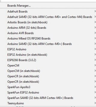

Paul - I had wondered if this beta would also show up as a new version for the Arduino boards packages...
i.e. if you had put the pieces in place to use the newer stuff in Arduino_cli that might better support headless...
I did confirm this morning the IDE 2 does not see new board updates. So I am assuming not. looks like I will need to remove it and/or simply continue
Nope. I automated building the package zip files (though it's currently broken on MacOS), but updating the package index is still a very manual process. I didn't do it for this beta.
I'm not planning to put much work into the new packages until Arduino fixes issue #769. Yeah, people wanting headless support from Arduino CLI could benefit even if the GUI isn't properly supported. And if #769 doesn't get fixed, I'll do that after 1.57 is released, and maybe also 1 or 2 times as we get closer to 1.57 release. Maybe.
But I do believe we need a patch in the Java code to force use of the libraries from the Teensyduino installer and ignore any other Teensy packages. People can still use the packages with an unpatched copy of Arduino 1.8.19, and of course with Arduino 2.0 beta. But when using a copy of Arduino which has been modified by Teensyduino, the installer's files should always be used no matter what packages exist elsewhere. Not quite sure how to do that, but in a future where the packages are more easily findable, we need this in the 1.57 release.
