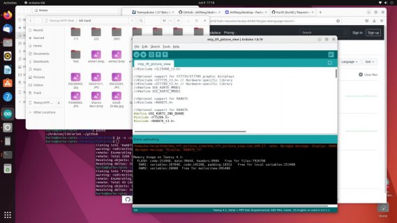

Tested our more extended picture viewer on RA8876 (not part of our default examples)... And it is working.
Minor notes: to those of us who use some different build tools...
TSET - I had to update slightly as the boards.txt has USB type=serialmtp and our temporary one had mtpserial...
Also TyCommander now shows (Teensyduino Generic) ...

I thought I would mention, that today I installed Ubuntu 22.04 onto an RPI4(8mb) on an SSD 64 bit.
Looked for Arduino 2, but did not see any for arch64, so installed 1.8.18 and installed TD 1.57b2.
I then installed enough libraries: mtp_teensy, jpeg_dec, ping_dec, ra8876... And then built our mtp_tft_picture_view (my github by that name),
I built using Serial + MTP for T4.1 on RA8876
And it built and programmed the T4.1 and I could Use MTP to talk to the Teensy.
And the images are showing up on my RA8876 display.
