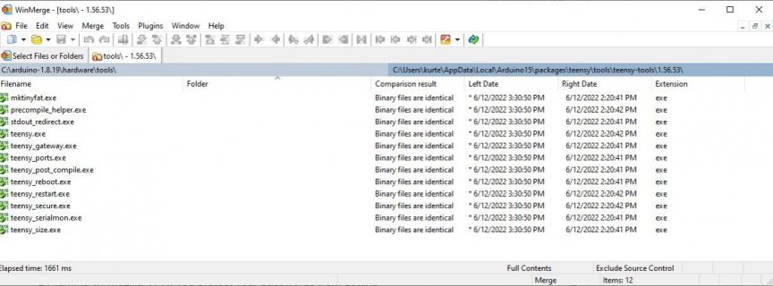

RE 'Secure' > I posted question a bit back p#15 - Asked if the Teensy_Secure.exe was rebuilt versus the IDE 1.8.x version that never triggered? Maybe the "eHex Crypto" code in it matches a RansomeWare/Crypto attack pattern/signature?
I thought I checked that back then. Did it just now and looks like, they are the same files... Used WinMerge to check... Probably not the best tool for this but:
