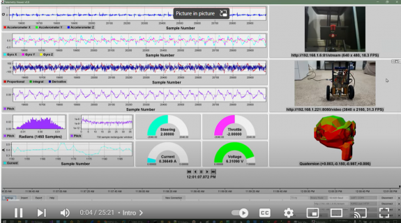

http://www.farrellf.com/TelemetryViewer/
There is actually another way if you want to use the approach that @defragster mentioned which doesn't involve using Serial Plotter which I always found to rather limiting. Several of us used it when we were playing around with @brtaylor's uNav librairies and that is to use Telemetry Viewer which allows you to do stuff like this:

Indeed, Telemetry Viewer is very COOL! Was on that thread for usage - a bit more overhead to set that up than IDE Plotter. Don't recall that PC messages used 'Send' to feedback to the Teensy? Not seeing UI space for that in p#30 image?

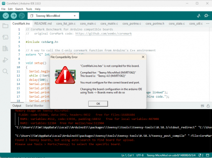

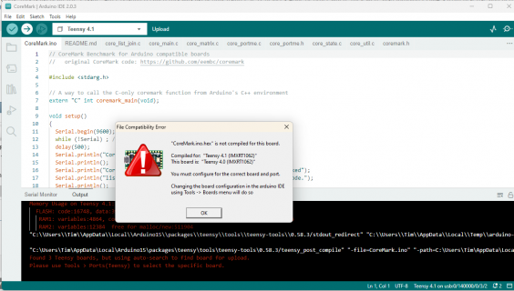

Updated IDE 2.0.3 to board Teensy 0.58.3.
T_4.1 selected and built - it explains the T_4.1 code will NOT work for T_4.0 - The T_4.0 is sitting in RED LED Bootloader:
Confused over usb:0/140000/0/3/3 versus .../3/2 shown in IDE selected.
This repro'd three times. Last time IDE 1.x closed. Then Un/Re plugged T_4.0 and pushed T_4.1 button.
Build/Upload to T_4.0 same fail text - except it triggered the T_4 bootloader and then programmed:
"C:\Users\Tim\AppData\Local\Arduino15\packages\teensy\tools\teensy-tools\0.58.3/teensy_post_compile" "-file=CoreMark.ino" "-path=C:\Users\Tim\AppData\Local\Temp\arduino-sketch-1A3DB2E340B8B896E40AF7FB4E1E3525" "-tools=C:\Users\Tim\AppData\Local\Arduino15\packages\teensy\tools\teensy-tools\0.58.3" "-board=TEENSY40" -reboot "-port=usb:0/140000/0/3/3" "-portlabel={serial.port.label}" "-portprotocol={serial.port.protocol}"
Found 3 Teensy boards, but using auto-search to find board for upload.
Please use Tools > Ports(Teensy) to select the specific board.

Noted above the T_4.0 worked by accident as that is the unit put into Bootloader. Changing to T_MM had same result of T_4.0 in bootloader and FAIL:
Here is the Verbose in a file for T_MM fail with T_4.0 RED LED ready: View attachment T_MMfail_IDE2.txt
Just saw IDE 1.8.19 and 2.0.3 same warning - new or not ??:

But, no board was in Bootloader when IDE was told to Build/Upload.
Somehow this T_4.0 board was 'addressed' to go to bootloader - even when the T_4.1 or T_MM were the selected port.
@PaulStoffregen: in furtherance of p#45,46 and #43
Using setup as in pjrc.com/threads/71975-Teensy-4-1-psram-memtest
Built again for T_4.1, did code edit to print added File&Date in setup() just to see the build to T_4.1 updated.
Build to T_4.1 as ONLY connected Teensy with IDE 2.0.3 w/TD 0.58.3 worked again reliably!
> Using IDE 2. Teensy_ports Sermon active before/'during'/after build as typical use.
Plugged T_4.0 into Win 11 PC front panel (versus shared HUB as before) and did BUILD again to upload to T_4.1. No other change.
That Build failed UPLOAD as noted in prior posts! The T_4.0 is now sitting in BOOTLOADER with RED LED
> File Compatibilty Teensy Dialog is displayed: Compile T_4.1 and Board is T_4.0
Teensy Verbose shows T_4.1 upload and USB #'s - then confused on T_4.0 and halted Upload:

[B]17:40:53.077 (ports 5):   port COM26 found from devnode
17:40:53.077 (ports 5): found_usb_device complete
17:40:53.078 (ports 5): usb_add: usb:0/140000/0/7  COM26 (Teensy 4.0) Serial[/B]

[B][COLOR="#FF0000"]17:41:16.891 (ports 5): found_usb_device, id=\\?\usb#vid_16c0&pid_0478#00093c74#{a5dcbf10-6530-11d2-901f-00c04fb951ed}
17:41:16.891 (ports 5): found_usb_device, loc=usb:0/140000/0/7    Port_#0007.Hub_#0002
17:41:16.891 (ports 5): found_usb_device, hwid=USB\VID_16C0&PID_0478&REV_0107
17:41:16.891 (ports 5): found_usb_device, devinst=00000025
17:41:16.891 (ports 5): add: loc=usb:0/140000/0/7, class=HID, vid=16C0, pid=0478, ver=0107, serial=00093c74, dev=\\?\usb#vid_16c0&pid_0478#00093c74#{a5dcbf10-6530-11d2-901f-00c04fb951ed}
17:41:16.891 (ports 5): hiddev_from_devinst_list: iface=0
17:41:16.892 (ports 5): found_usb_device complete
17:41:16.893 (ports 5): usb_add: usb:0/140000/0/7  [no_device] (Teensy 4.0) Bootloader
17:41:16.901 (loader): remote cmd from 1300: "status"
17:41:16.905 (loader): secure mode can not be locked: this is Standard Teensy
17:41:16.905 (loader): encryption is possible on this Teensy, but not yet configured
17:41:16.905 (loader): but without secure mode locked, encryption will NOT be secure!
17:41:16.905 (loader): Device came online, code_size = 2031616
17:41:16.905 (loader): Board is: Teensy 4.0 (IMXRT1062), version 1.07
17:41:16.918 (loader): File "C:\Users\Tim\AppData\Local\Temp\arduino-sketch-2FE75A633D7060765C147E7121984318\teensy41_psram_memtest.ino.hex", 51200 bytes
17:41:16.926 (loader): File "C:\Users\Tim\AppData\Local\Temp\arduino-sketch-2FE75A633D7060765C147E7121984318\teensy41_psram_memtest.ino.ehex", 51200 bytes, and 5536 loader utility
17:41:16.926 (loader): ehex is valid, key hash: 85A79CC1 B7C7F866 7F5BB3ED 0F9C9BA5 B4149EE2 72846D35 86B63863 B0699942
17:41:16.926 (loader): File "teensy41_psram_memtest.ino.hex". 51200 bytes, 3% used
17:41:16.972 (loader): set background IMG_ONLINE
17:41:16.984 (loader): File "C:\Users\Tim\AppData\Local\Temp\arduino-sketch-2FE75A633D7060765C147E7121984318\teensy41_psram_memtest.ino.hex", 51200 bytes
17:41:16.991 (loader): File "C:\Users\Tim\AppData\Local\Temp\arduino-sketch-2FE75A633D7060765C147E7121984318\teensy41_psram_memtest.ino.ehex", 51200 bytes, and 5536 loader utility
17:41:16.991 (loader): ehex is valid, key hash: 85A79CC1 B7C7F866 7F5BB3ED 0F9C9BA5 B4149EE2 72846D35 86B63863 B0699942
17:41:16.991 (loader): File "teensy41_psram_memtest.ino.hex". 51200 bytes, 3% used
17:41:17.031 (loader): elf appears to be for Teensy 4.1 (IMXRT1062) (8126464 bytes)
17:41:17.031 (loader): elf binary data matches hex file
17:41:17.031 (loader): elf file is for Teensy 4.1 (IMXRT1062)
17:41:17.031 (loader): Incompatible file, showing warning dialog[/COLOR][/B]
17:41:17.062 (reboot 21): Status: 1, 0, 1, 9, 0, 0, C:\Users\Tim\AppData\Local\Temp\arduino-sketch-2FE75A633D7060765C147E7121984318\, teensy41_psram_memtest.ino.hex
17:41:17.062 (reboot 21): status read, retry 3
17:41:17.062 (reboot 21): Success
17:41:17.062 (reboot 21): Disconnect
17:41:17.102 (loader): remote connection 1300 closed

@Paul - with Two T_4.1's connected Neither will program 'automatically' with IDE 2.0.3 they both give:
C:\Users\Tim\AppData\Local\Arduino15\packages\teensy\tools\teensy-tools\0.58.3/teensy_post_compile" "-file=teensy41_psram_memtest.ino" "-path=C:\Users\Tim\AppData\Local\Temp\arduino-sketch-2FE75A633D7060765C147E7121984318" "-tools=C:\Users\Tim\AppData\Local\Arduino15\packages\teensy\tools\teensy-tools\0.58.3" "-board=TEENSY41" -reboot "-port=usb:0/140000/0/6/1/4" "-portlabel={serial.port.label}" "-portprotocol={serial.port.protocol}"
[B][COLOR="#FF0000"]Found 2 Teensy boards, but using auto-search to find board for upload.[/COLOR][/B]
At the same time IDE 1.8.19 works to 'Auto' program with Windows 11 here and alternate between them by changing the Teensy_port.
Using SerMon tied to each IDE and closing the ports between trials, but both IDE's open.
