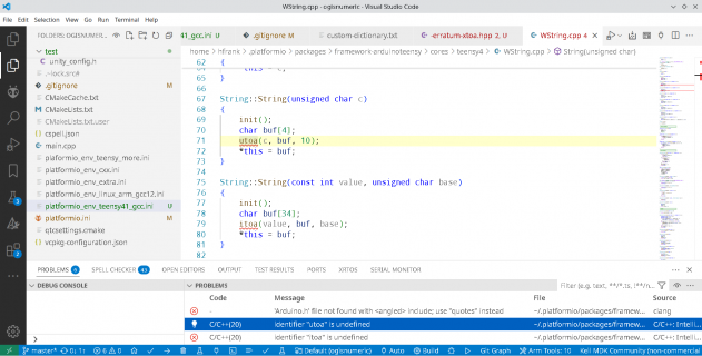

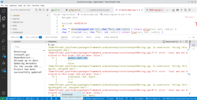

The problem of missing itoa() and utoa()
appears again 2025-03-04
using PlatformIO and the new toolchain-gccarmnoneeabi 1.14
[env]
platform = platformio/teensy@^5.0.0 #!v5.0.0
board = teensy41
framework = arduino
platform_packages =
platformio/framework-arduinoteensy@^1.159.0
platformio/toolchain-gccarmnoneeabi@^1.140201.0 #!THIS is new
lib_compat_mode = soft
lib_ldf_mode = deep+
see the error message and the mitigation in the screenshot.
OFFER:
I could assist in fixing the problem in the Arduino/Teensy Code.
The functions utoa() and itoa() seem to be not include in newlib.

Just ran a quick test using itoa() and utoa() and seems to be working at least on a Teensy 4:
C++:
char numberArray[20];
uint32_t number = 35000; // 5 digits
#define volumesize
    while(!Serial && millis() < 5000){}
   itoa(number,numberArray,10);
   Serial.println(numberArray);
  //https://users.pja.edu.pl/~jms/qnx/help/watcom/clibref/src/utoa.html
    int base;
    char buffer[18];
    for( base = 2; base <= 16; base = base + 2 )
      printf( "%2d %s\n", base,
          utoa( (unsigned) 12765, buffer, base ) );
OUTPUT:
35000
 2 11000111011101
 4 3013131
 6 135033
 8 30735
10 12765
12 7479
14 491b
16 31dd
NOTE: I am running 1.60-beta3. Not sure what version platform is using - never used it.
