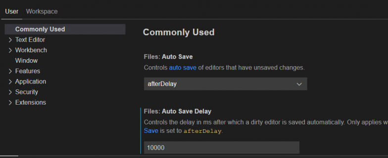

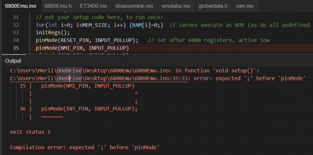

I figured out how I got the compile to happen with the missing semi-colon. I have autosave set to 6 seconds in my preferences.
It's probably an omission or a bug, but you can run "compile" or "upload" with a dirty file... you won't get prompted to save, and the disk image is yet unchanged.
That is masking what is the real problem, and that is that the directory for the project outputs gets deleted prior to teensyduino obtaining the .hex file. This seems to happen mostly after there was a failed compilation, and you fix the issue and try a new compilation.
That said, if none of you can reproduce this, the odds of anyone ever looking at it and fixing it are pretty slim.
- Wes, W5ZZO
Sorry couldn't find that setting in advanced - more than likely I did but do not know how to set. Probably someone else will
ctrl-shift-p in IDE 2.0.4. That is workplace settings, look in the Files portion. I had mine on 10000 (10 seconds).
I changed mine back to the default 1000 (milliseconds) setting... the last thing I want is to make a code change, compile upload the file and then scratch my head about why things appear the same as before.
But that was why my deleted semicolon did not generate an error, as 10 seconds was enough for the compiler to chew through the first file.

Also the main point I forgot to make was that if it's messing up in 2.0.4+ try in 1.89.19
with ctrl-shift-p I get list of commands /short-cuts but not workplace settings (2.0.4 Win11)
ctrl-shift-p, then find "Preferences: Open User Settings"
I also had issues with "tons of temp files" causing errors... mine was something about mingw making an illegal memory access, I assume it found more files than it had buffers, deleting /Temp fixed that.
As for 1.8.19, it is no longer installed. Too many features in 2.0 to give up. Just want 2.0 to be reliable.
- Wes
- Wes, W5ZZO
Ok with help from @KurtE I changed the autosave delay to 10000 from 1000:
I then compiled and uploaded your sketch no issues (just a test). I then removed a semi-colon and tried to reload the sketch and received the error message about missing semi-colon only... NOT what you are seeing:
Tried it a couple of times going back and forth with/without the semi-colon, couldn't duplicate what you are seeing.
