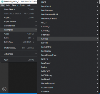

Was playing around with a library and decided to test propsheild again with NXPMotionsense but noticed that its no longer in the examples list of either 2.0.05 nightly or 1.8.19 with 0.59.2 not sure why to be honest
EDIT: Forgot - it is in the libraries folder for both when you look.
