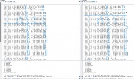

Other simple test that came to mind was: "...\LittleFS\examples\Test_Integrity\PSRAM\PSRAM.ino"
> that runs a series of LittleFS File Add/extend/delete tests and verifies file integrity across the changes
Ran that on 3 T_4.1's and no errors without or with PreFetch PR in place on 1.59.b2.
That code doesn't look to optimize speed - but integrity of reads/writes for LittleFS management. Though with PreFetch enabled a hundred/'K' series of loops the time did drop from: 186 down to 176 seconds.
> Not significant but consistent improvement. Writes are read back and files read before delete.
> The I/O changes are in 2KB to 7KB range across multiple files so Cache and PreFetch data won't always be useful.
Upped to larger and more files the thousand pass took 446 seconds before the PR 708 and 417 seconds with the PR and no corruption detected.
<EDIT> Ran LittleFS again with alt file file params to better use more disk space:

[B]GAVE[/B] this after 1000 loops with 'k':
Bytes Used: 5707776, Bytes Total:8388608
Loop Count: 1001 (#fileCycle=64235), Bytes read 2118896944, written 810482800, #Files=157
Both run the same test with same file sizes and order as the Integrity test did for Repro.
Larger files result in some faster reads up to 200KB/sec - some writes got that too.
Net overall - 10 to 11% improvement [Total I/O R+W=2,929,379,744 Bytes:
27.99M (1679 secs) without PreFetch Total I/O in time 1.744 MilB/sec
25.15M (1509 secs) with PreFetch : Total I/O in time 1.941 MilB/sec

Raw Results: Little FS NOR and NAND running with and without the PR 708 edit :: NO ERRORS
Elapsed times for these tests are remarkably similar showing no improvement like PSRAM case did when PR 708 change was made. Though the NOR is 2.66 minutes faster for the same process than NAND.
NAND::
[U]QSPI_NAND   4:54 PM 7/13/2023   NON-PR   ## 9600[/U]
[ 18.81 M]([B]18.47611 M elap[/B]) Awaiting input 0123456789RdDwcghkFqvplmusSBbyYxfan+-? loops left 0 >
Walk all Files verify Read Size:
	D1 CDEGHIJKLMNO
	D2 ABCDEFGHIJKLMNO
	D3 ABCDEFGHIJKLMNO
	D4 ABCDEFGHIJKMNO
	D5 ABCDEFGHIJKLMO
	D6 CDEFGHIJKMNO
ABCDEFGHIJKLMN	0 Errors found
Bytes Used: 14680064, Bytes Total:131596288
	 Loop Count: 102 (#fileCycle=4025), Bytes read 174110000, written 56138384, #Files=96
[B]QSPI_NAND   3:03 PM 7/13/2023   PR 708   ## 9600[/B]
[ 20.25 M]([B]18.47911 M elap[/B]) Awaiting input 0123456789RdDwcghkFqvplmusSBbyYxfan+-? loops left 0 >
	D1 CDEGHIJKLMNO
	D2 ABCDEFGHIJKLMNO
	D3 ABCDEFGHIJKLMNO
	D4 ABCDEFGHIJKMNO
	D5 ABCDEFGHIJKLMO
	D6 CDEFGHIJKMNO
NOR::
[U]QSPI_DISK  4:53 PM 7/13/2023  NON-PR    ## 8860[/U]
[ 16.18 M]([B]15.71656 M elap[/B]) Awaiting input 0123456789RdDwcghkFqvplmusSBbyYxfan+-? loops left 0 >
	D1 CDEGHIJKLMNO
	D2 ABCDEFGHIJKLMNO
	D3 ABCDEFGHIJKLMNO
	D4 ABCDEFGHIJKMNO
	D5 ABCDEFGHIJKLMO
	D6 CDEFGHIJKMNO
Bytes Used: 8912896, Bytes Total:16777216
[B]QSPI_DISK  3:05 PM 7/13/2023  PR 708    ## 8860[/B]
[ 16.62 M]([B]15.71530 M elap[/B]) Awaiting input 0123456789RdDwcghkFqvplmusSBbyYxfan+-? loops left 0 >
	D1 CDEGHIJKLMNO
	D2 ABCDEFGHIJKLMNO
	D3 ABCDEFGHIJKLMNO
	D4 ABCDEFGHIJKMNO
	D5 ABCDEFGHIJKLMO
	D6 CDEFGHIJKMNO
