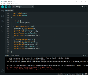

Does 1.59-beta5 solve the issue you were seeing with attempting upload to the wrong board? This one is still on my list of issues, so wanted to specifically ask if this is solved on your machine?
Powered down DevBoard and Powered Up: T_4.0 + T_4.1 + T_4.1
Opened Blink.ino in IDE 1.8.19
Selected Board/Port: 4.0 > Upload Good
Selected Board/Port: 4.1 > Upload Good
... another cycle or two and no issue, changed blink rate some in the process
@PaulStoffregen:
Not sure if I am seeing the same "attempting to upload to the wrong board" as @defragster, but here's the simple case where I am observing a similar (mis)behavior:
Conditions:
Arduino IDE 1.8.19 + TD 1.59b5
I created a "Blink" folder with the "Blink.ino" sketch in my Arduino source folder. This is important, as the two instances of the Arduino IDE have to be started from the Windows File Explorer (as opposed to using "Open With" or "Open" from the first IDE to start a second instance, where making configuration changes in one IDE also changes the configuration in the other IDE) to allow the two IDEs to be independent, in order to properly demonstrate the undesired behavior.
1) open the first instance of the Arduino IDE by navigating Windows File Explorer to the folder containing the "Blink.ino" sketch & double-clicking on the "Blink.ino" file

Windows 10, Arduino IDE 2.2.1. Sketch EchoBoth, HWSERIAL replaced with Serial1 and using DualSerial USB mode.
I tried 0.59.5 and still the same issue since 1.58.0: I have intermittent connections (shorter) and disconnections (longer).
Cannot see my dual serial ports on any terminal.
Firmware was already uploaded to T4.1 (after a long "reset" to default firmware so I can retrieve the ability to upload) and running when red message on Output is got by pushing the [Compile and upload] button.
EDIT: I also tried Blink. Once uploaded to T4.1(after a long "reset" to default firmware again) and running, I can see blinking but same issue as above. Set to RAW HID mode this time.
Now if I make blinking delay to 100ms instead of 1000ms, it blinks thrice then the led is OFF for almost the same delay than blinking then again it blinks thrice and so on. Definitely not normal. And still the same issue so far.

So getting back to 0.59.5, after uninstalling 1.57.2 and firing Teensy uploader, I reinstall 0.59.5 and recompile EchoBoth. Upload the firmware in Dual Serial mode and... have a stable connection to teensy port and still access to COM8 and COM9. G*d! It really wears me out !!!!
I see on another thread that replacing Serial1 with SerialUSB1 solved the problem. Is this problem fully resolved?
If there is something I should investigate, can you give me clear instructions to reproduce the problem and the code you're using? Please copy the actual code, not a graphics screenshot, so I'm able to copy your from this forum into Arduino IDE and follow your instructions to reproduce the problem. Please also understand I mostly use Linux, so if I must use Windows to reproduce this problem, please be detailed and specific because I'm not as familiar with Windows. I need clear and detailed instructions to reproduce the problem if it involves Windows.
I had been blocked upon 1.58.0 or later for over one year. So I was stuck on 1.57.2. Whenever I tried to install 1.58.0 or later, I get the same issue as above with no access to serial port(s) or to teensy port to upload next build and so no idea how the program ran. I'm really clueless about how I've now managed to install 0.59.5 this time, whereas I failed the previous time. Now the last process I did was :
- remove the one installed (1.57.2).
- kill the Teensy uploader as the process of safe installation may fail due to a locked script.
- then install the wanted one (0.59.5).
The program is basically the same as in here. Teensy 4.1, Faster, 600MHz, Dual Serial.
There was a time I could install 1.58.0 or later on my machines but then I couldn't.
Let us say the situation is solved concerning 0.59.5 and the issue may be due to improper way to uninstall/install steps.
Confirm, on Windows we have a known issue with Arduino IDE not being able to delete the files if Teensy Loader is still running. Sadly, the IDE doesn't check whether it really was able to delete the old files, and when a new install is done there is no checking whether old files will mess it up.
Arduino IDE 2.2.2 (still in testing) will add the ability to an uninstall script to run. 1.59 beta already has this script and it's been tested with the latest 2.2.2 nightly builds. Eventually when Arduino releases IDE 2.2.2 and 1.59 is released, this Windows uninstall (or switch versions which uninstalls the current version) will be fixed. It's an insidious and frustrating problem which hopefully will soon be forever solved (as people migrate to new IDE versions).
Plan is to add the uninstall script to all the old versions, so 1.57.2 will become 1.57.3 with exactly the same code but the uninstall script added.
