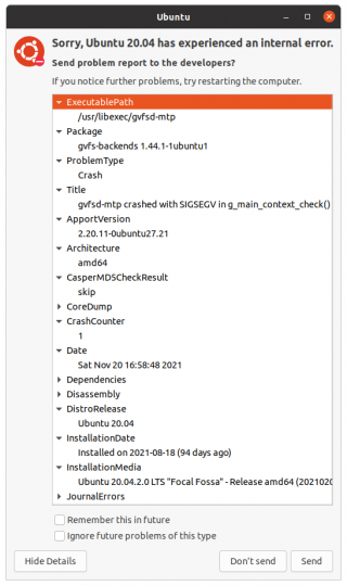

Observations, about differences between running MTP on Windows versus Ubuntu:
In this case running on T4.1 with MTP_Teensy -> Simple example, I have prop shield simple plugged in to it (sort of... 3 rails)
Note the 32gb SD Card I plugged in, has a copy of MTP_Teensy github on it... (that is I copied the github project to it) so I could try out some files on Ubuntu...
So, when I plugged this into Ubuntu (actually programmed it here), and the program launches I noticed the debug output showing a lot of stuff... If I do the '1' command you see:
So it looks like it totally scans the storage items up front. I have not even opened a window showing MTP yet...

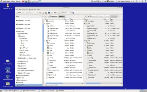

Now if I run on Windows you see:
Note: this Teensy auto loads a window when plugged in:
So the index list starts off only with the list of storage objects:
Now if I click to open up the SD Card I see the list grows to only include the root:
Now will be interesting to see what happens with MSC drives
