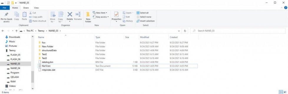

I hacked up the MTP_t4 test sketch mtp-test, that allows this as an option...
renamed the option that was there USE_LFS_QSPI to USE_LFS_QSPI_FLASH
And used this one...
Appeared to work...
Note: next play attempt will be for LittleFS_SPI
which says use that chip on pin 3...
Is this something I should upload and PR?
Kurt

@Paul, @mjs513 @defragster...
I think I am done playing with this for now. Question will be does it make sense to add these wrapper classes into the main LittleFS.h file or right now I have them as an
Individual header file for test program...
The Test program is using our updated integration stuff...
I changed the wrapper classes to be subclasses of FS not LittleFS as if you called any of the main LittleFS functions that do things other than the FS functions, it would grab the LFS token data which would be garbage... Could try hacks to copy the data.
protected:
	bool configured;
	bool mounted;
	lfs_t lfs;
	lfs_config config;
From the child objects, but issues of for example files opened from child will probably be working with childs copy...
So instead I have this object working at FS level, and then you can query it for the LittleFS object to work with...
So this add on file looks like:

It is also in the zip file included which has the example sketch that has several different T4.1 like storage added.
In this sketch on the T4.1 I tried it on, which has PSRAM so creates Ram drive, plus flash on bottom, plus is plugged into Paul's memory board with 4 storages...
Note: I tried formatting one of the storage chips on the board... But I am not sure MTP was happy after that...
It hopefully got the right data from our callback stuff to format the right one...
And then we also try to stall MTP from responding while the format is active.
  • SD_Program_SPI_QSPI_MTP-logger-210927a.zip
