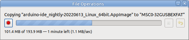

@KurtE @mjs513 - Decided to format my Kingston 120Gig SSD to ext4 and pile a couple of directories on it. I formatted the drive using sudo gparted with Ubuntu 20.04.
Result:
Seems to be something with RPI4 ext4 formatting. Really not sure:( Don't own a RPI4 just a RPI3. Hmmmm...I wonder?

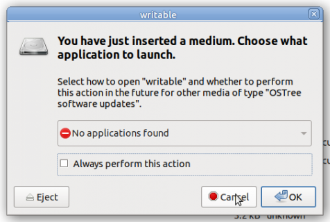

@KurtE @mjs513 - Was able to duplicate the problem with MTP and the PI writable directory. It shows empty:
I'll see if I can figure out what it is...

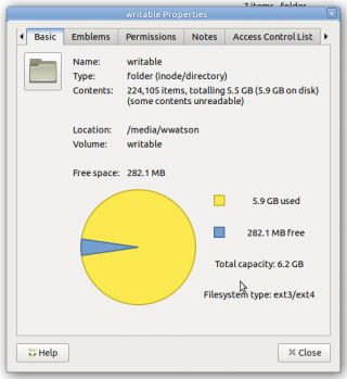

Edit: Just put it in my Linux machine and checked the properties of the writable directory:
You will see that some directories are unreadable. That could be why nothing is showing up...
Edit #2: There appears to be Something different with some of the directories that is not supported by lwext4. Even Linux takes note of the difference:
Looks like you need special software to deal with it so in normal use this should not be a problem:)

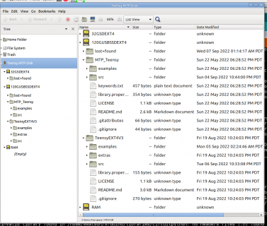

With a few adjustments to TeensyEXT4V3:
And:
Seems to work without issue:)

Showing updated files. If you look at several of the MTP sketches that have some basic Loging built in. like USB_MTP-logger.ino
(I mention this one as I updated it to use newer stuff today).
But for example when the command is executed to stop logging, it runs the code:
void stopLogging() {
  Serial.println("\nStopped Logging Data!!!");
  write_data = false;
  // Closes the data file.
  dataFile.close();
  Serial.printf("Records written = %d\n", record_count);
  MTP.send_DeviceResetEvent();
Which has the call to reset the device. In the sample run, that I just did it, we see:
Notice that the log file has not shown up. But then after I hit F5 it then shows up:
