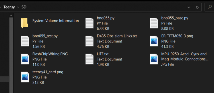

Not sure this is still an open issue but decided to play a bit and see if I was having the same issue. So I picked up a BME688 put together a MTP sketch that does three things.
1. Reads data from the BME688 every 5 seconds (sorry don't have all night) using the RTC - I could have used intervaltimer for this but was curious for a total of 10 readings.
2. When it completes it automatically stops logging data
3. Manually you run a copy command to copy the data from program flash to a SD Card.
Basically you start the sketch by typing the 's' command to start logging then when it completes you type the 'c' command to copy the file to the SD Card. NOTE: Make sure you delete the files when you get done - didn't put anything in the test sketch to do that. If you have the SD Card directory open you do need to hit the refresh button in windows dirctory but it works.
Note. At first I was having the same issue as you - after copying the file to the sd card it wouldn't appear unless i restarted the Teensy. To get around that added the MTP.send_DeviceResetEvent(); and then was able to see it.
I am attaching the sketch if you want to take a look.View attachment bme680test.ino
Here is a test session

2. send the copy command:
Copy File on Flash to SD Card
Files Writing
Record Number: 1, BytesWritten: 2036
Files Closed
before refreshing - notice the file LITF.txt is not there, this is copied data file.
after refreshing - notice that the LITF.txt is there
think I will work on the sketch some more just for the fun of it

Still seeing the file on the SD card when it completes transferring. Let me know how you think I should change the sketch. Maybe it the MAC app you are using. I am running on a Windows machine so that is the only other variable.
Mjs513:
I do not not see any major difference in the way that you are doing this than I am. Accept that my program logs a lot more data than just the BME280 stuff.
It must be the different implementation on the Mac than the PC. Since this is a Windows only protocol (MTP) it does not surprise me that it works differently on Windows than it does on the Mac.
Probably some nuance about MTP that has not been implemented in Macdroid.
Thanks,
Ed

You had mentioned trying a different MAC app for MTP and I think @KurtE mentioned one as well. Maybe if you have time to play around with it you can check out one of the other MTP implementations. Good luck
