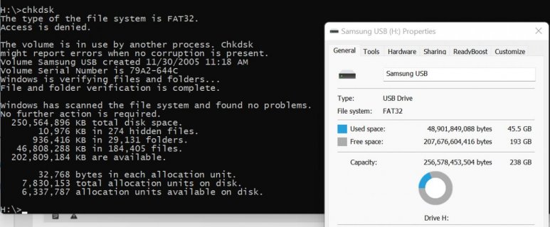

Yes ExFat is supported. Running 64gb exfat usb stick for my tests.
Have to remember windows and sdfat both will format 32gb and above as ExFat. And in the case of windows ntfs or ExFat. Sdfat formatted even has a warning about that

Ran DataloggerUSB and timed how long it took from the time I asked for a file list to when it started printing. Well, it took almost 31 seconds before space used got calculated - the directory started printing right after that no delays. So image a larger USB how long it will take. ExFat is a different story so doesn't seem to suffer the same faith.
KurtE said:Is there a problem only 30+ seconds?.... Sorry maybe too much rambling here... hope some of this makes sense

Last time I checked these functions were all private, so could not call them from external things like our callback.SDFat does have a few functions after it gets the sector count but does not write back to the SD card which guess makes sense - as you said not necessarily maintaind in FSINFO.
1. setfreeclustercount
2. updateFreeClusterCount
and somthing interesting that I just spotted
3. cacheFetchFat
this is all in FatPartition.h.
