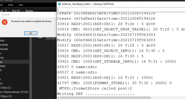

Format timing... I was playing around with some of the support for this today. I was trying to get to the point where in most cases the Forrmat starts, and we wait until completion and then we send the response to the host saying yep we are done... On most drives this is working OK.
Issue however is if it takes greater than time X, MTP will fail and nothing else works... So code is trying by starting up an Interval Timer, than start the format.
Then the IT checks to see if any pending messages are received, it will then try to respond with I am busy... Mentioned this before.
Addition however is that it then checks to see if Time X has occurred since I started the format, in which case it tries to send the response of I am done (More specific MTP_RESPONSE_OK)
That I tried to get to post from the IT... I am hoping that I can get it to send this, at which time the Host is free to send new messages, which I again will try to say I am busy.
Problem is it does not appear to be working fully. I do get the timeout, and I do look like I send a response back to host, that appears like the normal response like if the format had ended on time...
But in this case the host does end the Format busy dialog and say that the format failed... So something wrong... And even after the format completes which may be awhile, nothing works....
Note: put the MTP_Teensy changes in a WIP branch... In case anyone wishes to look before I get back to it in the morning.
One of the main things with MTP is everything is transactional. That is if for example if the user drops a 3mb image onto the storage, it will send a SendObjectInfo message, then followed by the whole set of bits... So there is no chance of any additional status or messages from the host until the whole 3MB has been sent and we have replied to the message.
Side note: I am thinking I may need to try an IntervalTImer approach to the SendObject as to hopefully allow us to pace the reading in of data to keep the host happy, especially when we do writes to some LittleFS storages which can take a long long time.
