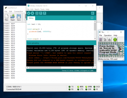

Hello forum,
I have here a couple of Teensy-LCs and ran into trouble recently on a single PC with the Arduino 1.6.12 IDE:
First, it is not possible to upload a program using the 'upload' button of the IDE, only the hardware button on the Teensy-LC is working. I'm getting this error message:
Found serial '\\.\COM6', but unable to open for reboot request
Teensy did not respond to a USB-based request to automatically reboot.
Please press the PROGRAM MODE BUTTON on your Teensy to upload your sketch.​
Further, the Serial Monitor isn't working. I'm getting 'Port busy'.

I did some more investigations using a small tool called ComMonitor V 1.0.
I found, that the virtual COM Port of the Teensy is getting locked immediately as it appears after plugging in the Teensy. But the strange thing is, that this happens only with the Teensy. I've never seen this with other COM adapters like FTDI and so on.

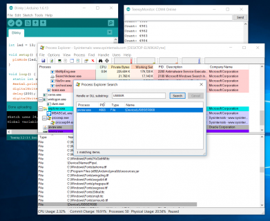

Ok, here's another idea. I just tried this on Windows 10 and it seems to work.
This uses Process Explorer. You can download it here (scroll to the bottom of the page):
https://technet.microsoft.com/en-us/sysinternals/processexplorer.aspx
When you run it, a window will appear with tons of system info you don't need.
Click the Find menu, and select the only option, which is Find Handle or DLL...
In the dialog box, for Handle or DLL substring, type USBSER and click Search.
Here's how it looks:
(click for full size)
In this case, it found process #4668 named "javaw.exe" is using \Device\USBSER000, which is COM4 on my machine.
This isn't perfect. In fact, it's pretty cryptic. It doesn't tell you "Arduino" or "Serial Monitor" is using the port. All you get is the process ID number and "javaw.exe", which is the Java virtual machine that actually executes the Arduino IDE.
Hopefully whatever program on your PC is hogging the port will be apparent from the name. If not, at least you get the PID number. Maybe with that you can track it down with the Task Manager or other normal Windows system monitoring tools?
The other cryptic detail is "\Device\USBSER000" rather than the familiar COM4 name. I believe the mapping from COM port numbers to these handle names can be found in the registry, under HKEY_LOCAL_MACHINE\Hardware\DeviceMap\SerialComm.
This is really stretching the limits of my knowledge of Windows. If anyone reads this and knows what Windows APIs ProcessMonitor uses to do this search and find that process ID and name, please let me know?! In my dream world of plenty of programming hours for everything, I'd love to have teensy_reboot.exe do this search and actually tell you this info, instead of merely "unable to open for reboot request".

Using the Process Explorer is also a very neat idea! But unfortunately so far it didn't help either: Not before and also after starting the Arduino IDE it can't find any reference to USBSER ...

This is, what I got:
Found serial '\\.\COM3', but unable to open for reboot request
Windows Error Info: Zugriff verweigert
more ideas... https://forum.pjrc.com/threads/40632-Teensyduino-USB-issue?p=126667&viewfull=1#post126667
The text Zugriff verweigert is German for access denied.
So, this is unfortunately nothing new...
Ok, so looks like there some unusual Windows setup here where your user account lacks permission to access the COM port. This is the norm on Linux, which is the reason for the udev rule file.
On Windows, the default is for access to be allowed to COM ports, even for non-admin users. I honestly have no idea how this setup could have happened, or what you actually do in Windows to manage permissions for COM ports.
Maybe someone who knows Windows better will be able to comment? I'm really curious to hear, if anyone knows or has ideas?

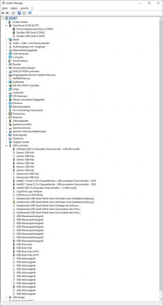

Do you have by chance any modem drivers installed (I remember some IBM notebooks came still with pre-installed analog modem drivers in 2014) ? I also met sometimes serial access problems in Windows with some sound card drivers coming with a telephony or fax utility which would install automatically and block the ports in the background...
A look onto Windows' device manager (Gerätemanger?) could be helpful, though, especially in checking if there are any real or virtual com ports shown.
COM1 is a physical COM port on the mainboard, COM3 is Teensy, COM4 the same, but not connected. And before I deleted all unused serial devices.

Edit: Ah hah! Running Process Explorer as Administrator says that the port is being used by a Node.js server run by Autodesk Print Studio! Apparently it's a Service that starts automatically on startup? WTF Autodesk. Killing the process makes it work, but I haven't figured out how to disable it permanently yet.
Windows ver#? Does Task Manager have a 'Startup Tab' Showing Autodesk? If so set that to 'Disabled' and restart to see the effect.
