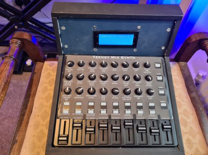

Here it is in its completed form, always nice to get the clothes on.

How is it working for you? Could you share a photo of your build?
Photos as requested. And it works fine! But I'm still struggling with working out the use of some of the knobs. So can I repeat my previous request? I have looked at the control_map spreadsheet. This contains an abbreviation of the purpose of each knob/slider, eg. OSC_FM_MOD_PHASE_MOD_ENV_2, but this doesn't mean a lot to me. Do you have a fuller description of the use of each knob, and perhaps a schematic of how they're all related? I'd be most grateful.
