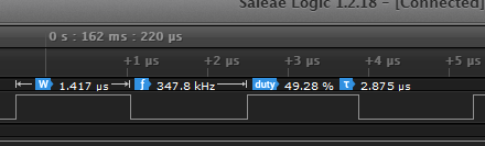

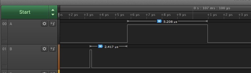

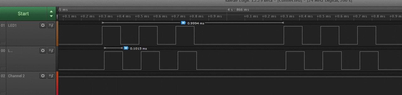

I did a kludge to DCCWaveform.cpp to use the IntervalTImer for T3.x and GPT for T4.1. I just did a test with the arduino motor shield with a T3.5 and hook up a LogicAnalzer to pin2 power and pin 12 (signal) and got the following waveform:
The short pulses are 58.1us and the long about 116us - think within specs. 58 = digit 1 and 116 = digit 0. And Power pin goes high when I turn on track power. So think the kludge worked. Tomorrow may hook up a test track and see what happens. Here is the kludge (looking forward to see what you come up with):
