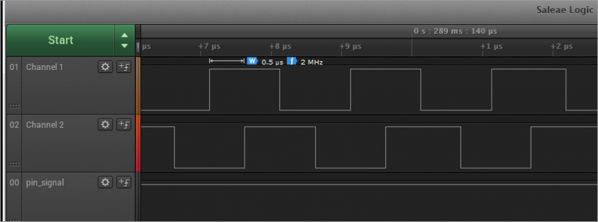

Thank you Luni for your Pulsegenerator post. Coincidentally I am implementing a pulsegenerator for 13 channels on the FlexPWM2/3/4 pins.
The pulses are typically 2-50us long. At the moment I'm using 13 OneShotTimers using TCK64 for scheduling, and testing whether to use the DoubleExposure example adapted to generate the pulse itself. I think a downside is that any delay on calling the tick timer would increase the pulselength when using TCK*. Another option I used before was to use noInterrupts() and just count the number of ARM_DWT_CYCCNT counter ticks.
Do you think the DMA based pulsegenerator would be a better fit, even if using FlexPWM channels?
Depends on your requirements of course. I currently implemented the DMA pulse generator only for the TMR/QUAD timers. It was more or less an exercise in DMA programming (which I didn't do so far). To extend the TMR code to the FlexPWM timers I need to read into the documentation first (which will not happen soon). If you want to implement the pulse generator code for the FlexPWM channels I'd be more than willing to integrate it to the library.
I tried to get into it but I'm afraid I'm not well versed enough yet to implement it.
For now the TCK based approach works very well, once again thanks for the library. In the callback, I use
void PulseGenerator::callback()
  noInterrupts();
  digitalWriteFast(pin, HIGH);
  delayNanoseconds( width );
  digitalWriteFast(pin, LOW);
  interrupts();
This gives a pulse of the correct length +26ns.

I am trying to create some code to make a quadrature encoder simulator. This would run on Teensy T4.1#1. Teensy T4.1#2 would decode the signals generated from #1.
So on Teensy T4.1#1, I was able to create a periodic timer that passes a parameter to the callback function. It seems the last argument is in the units of microseconds. Is there a way to do this in ns? Ideally the variable would just be a number in ns. I would like the duty factor to be 50%, but the period to be controlled by the passed parameter. This code is only me learning how to use this library.

Your code is a bit convoluted. The problems you get are probably due to the short period and the relatively (to the calling period) long blocking in the callbacks.
I'd do something like this:
#include "TeensyTimerTool.h"
using namespace TeensyTimerTool;
PeriodicTimer t1(TMR1);  // the TMRs run at 150MHz
constexpr int A = 1, B = 2;
uint8_t maskA = 0b11001100;
uint8_t maskB = 0b10011001;
void onTimer()
    static unsigned pos = 0;
    digitalWriteFast(A, maskA & (1 << pos));
    digitalWriteFast(B, maskB & (1 << pos));
    pos = (pos + 1) % 8;
    for (uint8_t pin : {A, B, LED_BUILTIN})
        pinMode(pin, OUTPUT);
    t1.begin(onTimer, 0.5us);
    digitalToggleFast(LED_BUILTIN);
    delay(250);
Which gives a 2 Mcnt/sec quad signal:
(for those short periods it is best to set the TMR prescaler to 1 in defaultConfig.h)
You might also be interested in this library: https://github.com/luni64/EncSim which generates Quad signals with settable frequencies, settable phases, and additional bounce pulses.
