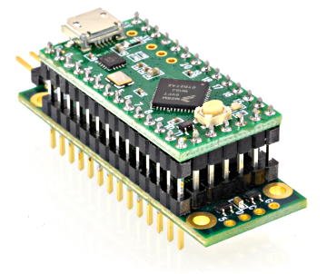

Thanks, should have googled that one harder. Got the rebuilt executable to run, but having the same problems. Just to clarify, this doesn't need any hardware to run correctly, other than the Teensy and prop shield, yes? Would extra wiring mess it up?

Alright, I'm getting a communication error only when I try writing things to the prop shield. I have erased the chip; -l and -i don't give me communication errors. And after I get a communication error I have to unplug it and plug it back in to fix the connection. Any ideas?
Sorry propshield+TeensyTransfer is still not working for you.
1) can you attach a photo of your setup (wiring and soldering)
2) Do the SerialFlash examples work? Examples > SerialFlash > ... first run EraseEverything, then RawHardWareTest (what does RawHardwareTest write on monitor?), then EraseEverything and ListFiles (you may need to run other examples to put files on SerialFlash, or create your own file creation sketch) Note: if you want to run RawHardwareTest again, you must run EraseEverything first. And run EraseEverything before starting to create files.
3) For TeensyTransfer you have to build and load Examples > TeeensyTransfer > teensytransfertool and in Tools you must change USB Type to Raw HID. What does teensytransfer -i report? teensytransfer -l ? teensytransfer yourfile ?
4) if you get errors, can you paste into your post the actual messages

I'm a total newbie and I'm working on a project where I need files on the Prop Shield. Somehow I can't get to Raw HID connection. I only get this message "teensytransfer: no rawhid device found". I'm working with Teensy 3.2, Prop Shield, Arduino 1.9.13, Teensyduino 1.53. What am I doing wrong?

You might mention what operating system you are using, there might be OS specific things you need to do. Teensydunio 1.53 now checks if Linux has the correct udev rules, but I don't know if there are Windows or MacOS specific things to do.
Thanks for the answer! I am using Windows and I'm still trying. I also found that when compiling tetransfertool.ino I miss some header files. I am a real amateur, but i promised my daughter to build this lightsabre, so i will install linux if necessery. Fun continues and I am grateful for any input.
when building teensytransfertool, in the IDE Tools dropdown menu, you must first set USBType to Raw HID Then after build and load, windows should recognize the Raw HID device, and you can run teensytransfer.exe. Try teensytransfer -i
teensytransfer -i

Thanks a lot manitou! I have set it to Raw HID. What do you mean with "building teensytransfertool, in the IDE Tools dropdown menu"?
I missed that you were still trying to compile the teensytransfer device. It can be rather tricky to build.
If Windows has separate window for the Teensy downloader that pops up after you've installed a sketch like blink, you might be able to load the pre-compiled image in the 'extras' directory:
  • extras/T32_teensytransfertool_with_SerFlash_CSPIN6.ino.hex
After the download window pops up, there should be a 'File' menu. From there do File -> Open Hex File. When prompted for a file, locate the above .hex file, and click on it. Then press the program button on the Teensy 3.2, and the download tool should load the hex file onto the Teensy. Assuming it installed, then exit both the Teensy IDE and the download window. After you have exited both programs, unplug/replug the Teensy. You should then be able to do a teensytransfer -i to identify that you have the prop shield installed.
