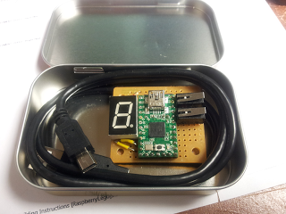

I have made a few projects with my Teensy 2.0's. This is the first I can show off.
It is based off of some of the projects out there (though, pre the macro keyboard one).
http://www.goewert.org/2012/08/teensytyper-teensyduino-usb-keyboard.html
I just wanted a dongle that could run through several keyboard scripts to get me through typing some annoying sets of keys. I wanted it to fit in my pocket, in the same way a full sized keyboard doesn't.
Full source and breadboard schematics are on my github page.
https://github.com/jgoewert/TeensyTyper
