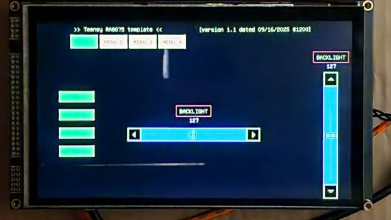

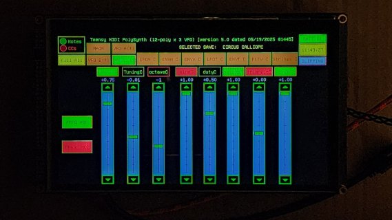

As may have been viewed in <this> other thread (@KurtE posted there, so I know he's seen it), I created a button & slider template for the RA8875 screen. I was inspired by the work of @KrisKasprzak & a library that he created. I wanted additional functionality, so using Kris's work as a starting point, I created my own version. I did my initial work using the ILI9341 display to control an updated version of my TeensyMIDIPolySynth (TMPS) (using buttons & sliders to control the characteristics of the synthesizer components in real-time). Due to limited screen area, I eventually transitioned to using a 7" RA8875 based display (more usable area & very responsive to inputs, without adversely affecting other things that the controlling Teensy was managing, including MIDI, debug serial, inter-processor comms with a T4.0, etc.).
I don't know if any of these implementations and/or concepts might be applicable in your work with the ST7796, but I present them here for your review, in hopes that something might prove beneficial.
FEATURES:
- configurable button size & location
- configurable button colors (active, inactive, background/foreground for active/disabled, border)
- configurable slider size & location
- configurable slider tick marks (major & minor, background/foreground color for active/disabled)
- configurable slider handle (color for active/disabled, border color for active/disabled)
- configurable slider min/max values
- configurable slider value display (places before/after decimal, sign, location, background/foreground colors)
- configurable slider bump arrows (short press for moving one increment/decrement value, long press for continuous increment/decrement change, with configurable increment/decrement value, configurable repeat)
- configurable slider colors (active/disabled)
- configurable slider orientation (horizontal/vertical)
Mark J Culross
KD5RXT
Pictures of template example sketch output & a typical VFO control screen from my TMPS attached (sorry for the poor photography . . . TFT screens are very difficult subjects to take pictures of !!) . . . code included as well, of course.

// PIN D40/A16  = (not used)
// PIN D41/A17  = (not used)
// onboard LED on pin 13
#define LED_PIN 13
#define LED_PIN_ON 16
#define LED_PIN_OFF 0
// keep track of splash screen delay
const int CHECK_SPLASH_MILLIS = 4000;
unsigned long check_splash_time;
// keep track of when the screen needs to be updated
boolean screen_update_required = false;
// keep track of how often to check touchscreen
const int CHECK_TOUCHSCREEN_MILLIS = 20;
unsigned long check_touchscreen_time = millis();
// custom RA8875 TFT colors (5-bit RED, 6-bit GREEN, 5-bit BLUE)
#define RA8875_DIMGREY     0x6B4D
#define RA8875_MDGREY      0x8410
#define RA8875_ASHGREY     0xB5F6
#define RA8875_ORANGE      0xFB00
typedef enum
   CONFIG_MODE_SPLASH = 0, CONFIG_MODE_INIT_SCREEN,
   CONFIG_MODE_MENU1, CONFIG_MODE_MENU2, CONFIG_MODE_MENU3, CONFIG_MODE_MENU4,
}  CONFIG_MODE;
CONFIG_MODE config_mode = CONFIG_MODE_SPLASH;
boolean previously_touched = false;
boolean touch_triggered = false;
// global touchscreen coordinates (in pixels) where touched
int16_t BtnX = -1, BtnY = -1;
struct BUTTON_TYPE
   unsigned int   xCenterLoc;
   unsigned int   yCenterLoc;
   unsigned int   xSize;
   unsigned int   ySize;
   const String*  textPtr;
   uint16_t       textColor;
   uint16_t       buttonColor;
   uint16_t       borderColor;
   boolean        activated;
// create button objects, passing in the display object
// UNIQUE PORTION OF THE DISPLAY SCREEN (only used for clearing the bottom portion of the screen & detecting touches)
const String uniqueScreenAreaText         = "";
BUTTON_TYPE uniqueScreenArea              = {400, 270, 800, 420,     &uniqueScreenAreaText,  RA8875_BLACK,  RA8875_BLACK,  RA8875_BLACK,  true};
// CHANGING BUTTON PORTION OF THE DISPLAY SCREEN (only used for clearing/redrawing buttons when changing menus)
const String buttonScreenAreaText         = "";
BUTTON_TYPE buttonScreenArea              = {400,  81, 630,  50,     &buttonScreenAreaText,  RA8875_BLACK,  RA8875_BLACK,  RA8875_BLACK,  true};
// PRIMARY BUTTONS
const String menu1ButtonText              = "MENU 1";
BUTTON_TYPE menu1Button                   = {120,  48, 70, 36,            &menu1ButtonText,  RA8875_BLACK,  RA8875_GREEN, RA8875_ORANGE, false};
const String menu2ButtonText              = "MENU 2";
BUTTON_TYPE menu2Button                   = {195,  48, 70, 36,            &menu2ButtonText,  RA8875_BLACK,  RA8875_GREEN, RA8875_ORANGE, false};
const String menu3ButtonText              = "MENU 3";
BUTTON_TYPE menu3Button                   = {270,  48, 70, 36,            &menu3ButtonText,  RA8875_BLACK,  RA8875_GREEN, RA8875_ORANGE, false};
const String menu4ButtonText              = "MENU 4";
BUTTON_TYPE menu4Button                   = {345,  48, 70, 36,            &menu4ButtonText,  RA8875_BLACK,  RA8875_GREEN, RA8875_ORANGE, false};
// MENU 1 BUTTONS
const String menu1BacklightButtonTextV    = "BACKLIGHT";
BUTTON_TYPE menu1BacklightButtonV         = {750, 91, 90, 30,  &menu1BacklightButtonTextV,  RA8875_GREEN,  RA8875_BLACK,    RA8875_RED,  true};
const String menu1BacklightButtonTextH    = "BACKLIGHT";
BUTTON_TYPE menu1BacklightButtonH         = {400, 240, 90, 30,  &menu1BacklightButtonTextH,  RA8875_GREEN,  RA8875_BLACK,    RA8875_RED,  true};
const String menu1Button1Text             = "BUTTON 1-1";
BUTTON_TYPE menu1Button1                  = {100, 200, 90, 30,           &menu1Button1Text,  RA8875_BLACK,  RA8875_GREEN,    RA8875_RED,  true};
const String menu1Button2Text             = "BUTTON 1-2";
BUTTON_TYPE menu1Button2                  = {100, 250, 90, 30,           &menu1Button2Text,  RA8875_BLACK,  RA8875_GREEN,    RA8875_RED,  true};
const String menu1Button3Text             = "BUTTON 1-3";
BUTTON_TYPE menu1Button3                  = {100, 300, 90, 30,           &menu1Button3Text,  RA8875_BLACK,  RA8875_GREEN,    RA8875_RED,  true};
const String menu1Button4Text             = "BUTTON 1-4";
BUTTON_TYPE menu1Button4                  = {100, 350, 90, 30,           &menu1Button4Text,  RA8875_BLACK,  RA8875_GREEN,    RA8875_RED,  true};
// MENU 2 BUTTONS
const String menu2Button1Text             = "BUTTON 2-1";
BUTTON_TYPE menu2Button1                  = {100, 200, 90, 30,           &menu2Button1Text,  RA8875_BLACK,  RA8875_GREEN,    RA8875_RED,  true};
const String menu2Button2Text             = "BUTTON 2-2";
BUTTON_TYPE menu2Button2                  = {100, 250, 90, 30,           &menu2Button2Text,  RA8875_BLACK,  RA8875_GREEN,    RA8875_RED,  true};
const String menu2Button3Text             = "BUTTON 2-3";
BUTTON_TYPE menu2Button3                  = {100, 300, 90, 30,           &menu2Button3Text,  RA8875_BLACK,  RA8875_GREEN,    RA8875_RED,  true};
const String menu2Button4Text             = "BUTTON 2-4";
BUTTON_TYPE menu2Button4                  = {100, 350, 90, 30,           &menu2Button4Text,  RA8875_BLACK,  RA8875_GREEN,    RA8875_RED,  true};
// MENU 3 BUTTONS
const String menu3Button1Text             = "BUTTON 3-1";
BUTTON_TYPE menu3Button1                  = {100, 200, 90, 30,           &menu3Button1Text,  RA8875_BLACK,  RA8875_GREEN,    RA8875_RED,  true};
const String menu3Button2Text             = "BUTTON 3-2";
BUTTON_TYPE menu3Button2                  = {100, 250, 90, 30,           &menu3Button2Text,  RA8875_BLACK,  RA8875_GREEN,    RA8875_RED,  true};
const String menu3Button3Text             = "BUTTON 3-3";
BUTTON_TYPE menu3Button3                  = {100, 300, 90, 30,           &menu3Button3Text,  RA8875_BLACK,  RA8875_GREEN,    RA8875_RED,  true};
const String menu3Button4Text             = "BUTTON 3-4";
BUTTON_TYPE menu3Button4                  = {100, 350, 90, 30,           &menu3Button4Text,  RA8875_BLACK,  RA8875_GREEN,    RA8875_RED,  true};
// MENU 4 BUTTONS
const String menu4Button1Text             = "BUTTON 4-1";
BUTTON_TYPE menu4Button1                  = {100, 200, 90, 30,           &menu4Button1Text,  RA8875_BLACK,  RA8875_GREEN,    RA8875_RED,  true};
const String menu4Button2Text             = "BUTTON 4-2";
BUTTON_TYPE menu4Button2                  = {100, 250, 90, 30,           &menu4Button2Text,  RA8875_BLACK,  RA8875_GREEN,    RA8875_RED,  true};
const String menu4Button3Text             = "BUTTON 4-3";
BUTTON_TYPE menu4Button3                  = {100, 300, 90, 30,           &menu4Button3Text,  RA8875_BLACK,  RA8875_GREEN,    RA8875_RED,  true};
const String menu4Button4Text             = "BUTTON 4-4";
BUTTON_TYPE menu4Button4                  = {100, 350, 90, 30,           &menu4Button4Text,  RA8875_BLACK,  RA8875_GREEN,    RA8875_RED,  true};
#define BUMP_REPEAT_START_DELAY_MILLISECONDS 750
typedef enum
   SLIDER_MODE_HORIZONTAL = 0, SLIDER_MODE_VERTICAL
}  SLIDER_MODE;
struct SLIDER_TYPE
   unsigned int   xSize;
   unsigned int   ySize;
   float          value;
   unsigned int   minorTickSections;  // normally = 10
   unsigned int   majorTickSections;  // normally =  2
   unsigned int   placesBeforeTheDecimal;
   unsigned int   placesAfterTheDecimal;
   boolean        showPlusMinusSign;
   float          minValue;  // for HORIZONTAL = all the way to the left, for VERTICAL, all the way up
   float          maxValue;  // for HORIZONTAL = all the way to the right, for VERTICAL, all the way down
   boolean        withBumpUpArrow;
   boolean        withBumpDownArrow;
   float          bumpValue;
   unsigned int   xValueCenterLoc;
   unsigned int   yValueCenterLoc;
   uint16_t       valueColor;
   uint16_t       backgroundColor;
   uint16_t       scaleColor;
   uint16_t       handleColor;
   uint16_t       handleBorderColor;
   uint16_t       backgroundColorDisabled;
   uint16_t       borderColorDisabled;
   uint16_t       scaleColorDisabled;
   uint16_t       handleColorDisabled;
   uint16_t       handleBorderColorDisabled;
   uint16_t       bumpBackgroundColor;
   boolean        activated;
   boolean        repeatEnabled;
   boolean        previouslyTouched;
   unsigned long  touchStartMillis;
   unsigned int   repeatMilliseconds;
   SLIDER_MODE    orientation;
SLIDER_TYPE  menu1BacklightSliderV    = { 750,  305,  30, 255, 127.00, 16, 2, 3, 0, false,     1.0,    255.0,  true, true, 1.00, 750, 115, RA8875_WHITE, RA8875_MDGREY, RA8875_GREEN, RA8875_BLACK,   RA8875_GREEN, RA8875_BLACK,   RA8875_BLACK, RA8875_MDGREY, RA8875_MDGREY, RA8875_MDGREY, RA8875_BLACK, RA8875_BLACK, true,  true, false, 0, 250, SLIDER_MODE_VERTICAL };
SLIDER_TYPE  menu1BacklightSliderH    = { 400,  305, 255,  30, 127.00, 16, 2, 3, 0, false,     1.0,    255.0,  true, true, 1.00, 400, 265, RA8875_WHITE, RA8875_MDGREY, RA8875_GREEN, RA8875_BLACK,   RA8875_GREEN, RA8875_BLACK,   RA8875_BLACK, RA8875_MDGREY, RA8875_MDGREY, RA8875_MDGREY, RA8875_BLACK, RA8875_BLACK, true,  true, false, 0, 250, SLIDER_MODE_HORIZONTAL };
// function headers
void centerDrawText(const String text, unsigned int xCenterLoc, unsigned int yCenterLoc, uint16_t textColor, uint16_t textBackground);
boolean checkButton(BUTTON_TYPE thisButton);
boolean checkSlider(SLIDER_TYPE* thisSlider);
boolean checkSliderBumpDown(SLIDER_TYPE* thisSlider);
boolean checkSliderBumpUp(SLIDER_TYPE* thisSlider);
void drawButton(BUTTON_TYPE thisButton);
void drawScreen(void);
void drawSlider(SLIDER_TYPE thisSlider);
void loop();
boolean processTouchscreen(void);
void setup();
// draw text, centered around xLoc & yLoc
   unsigned int xOffset = (text.length() * 8) / 2;
   unsigned int yOffset = 8;
   tft.setTextColor(textColor, textBackground);
   tft.setTextSize(1);
   tft.setCursor(xCenterLoc - xOffset, yCenterLoc - yOffset);
   tft.print(text);
}  // centerDrawText
// check if a button was pressed
   boolean retVal = false;
   // if touched most recently in thisButton
   if ((BtnX >= (uint16_t)(thisButton.xCenterLoc - (thisButton.xSize / 2))) &&
         (BtnX <= (uint16_t)(thisButton.xCenterLoc + (thisButton.xSize / 2))) &&
         (BtnY >= (uint16_t)(thisButton.yCenterLoc - (thisButton.ySize / 2))) &&
         (BtnY <= (uint16_t)(thisButton.yCenterLoc + (thisButton.ySize / 2))))
      retVal = true;
   return (retVal);
}  // checkButton()
// check if a slider has changed
   float newValue = 0.0f;
   // if thisSlider is active & touched most recently in thisSlider
   if (thisSlider->activated)
      if (thisSlider->orientation == SLIDER_MODE_VERTICAL)
         // if touched most recently in thisSlider
         if ((BtnX >= (uint16_t)(thisSlider->xCenterLoc - ((thisSlider->xSize / 2) + 15))) &&
               (BtnX <= (uint16_t)(thisSlider->xCenterLoc + ((thisSlider->xSize / 2) + 15))) &&
               (BtnY >= (uint16_t)(thisSlider->yCenterLoc - ((thisSlider->ySize / 2)))) &&
               (BtnY <= (uint16_t)(thisSlider->yCenterLoc + ((thisSlider->ySize / 2)))))
            if (BtnX < (uint16_t)(thisSlider->xCenterLoc - (thisSlider->xSize / 2)))
               BtnX = (uint16_t)(thisSlider->xCenterLoc - (thisSlider->xSize / 2));
            if (BtnX > (uint16_t)(thisSlider->xCenterLoc + (thisSlider->xSize / 2)))
               BtnX = (uint16_t)(thisSlider->xCenterLoc + (thisSlider->xSize / 2));
            if (BtnY < (uint16_t)(thisSlider->yCenterLoc - (thisSlider->ySize / 2)))
               BtnY = (uint16_t)(thisSlider->yCenterLoc - (thisSlider->ySize / 2));
            if (BtnY > (uint16_t)(thisSlider->yCenterLoc + (thisSlider->ySize / 2)))
               BtnY = (uint16_t)(thisSlider->yCenterLoc + (thisSlider->ySize / 2));
            newValue = (float)map((float)BtnY, (float)(thisSlider->yCenterLoc - (thisSlider->ySize / 2)), (float)(thisSlider->yCenterLoc + (thisSlider->ySize / 2)), thisSlider->maxValue, thisSlider->minValue);
            if (newValue != thisSlider->value)
               thisSlider->value = newValue;
               retVal = true;
            // if thisSlider is active & has either bump arrow & has been held & was touched most recently in thisSlider's bump arrow area
            if ((thisSlider->withBumpDownArrow || thisSlider->withBumpUpArrow) && (thisSlider->repeatEnabled))
               // if touched most recently in thisSlider's bump up arrow
               if ((BtnX >= (uint16_t)(thisSlider->xCenterLoc - ((thisSlider->xSize / 2)))) &&
                     (BtnX <= (uint16_t)(thisSlider->xCenterLoc + ((thisSlider->xSize / 2)))) &&
                     (BtnY >= (uint16_t)(thisSlider->yCenterLoc - ((thisSlider->ySize / 2) + 50))) &&
                     (BtnY <= (uint16_t)(thisSlider->yCenterLoc - ((thisSlider->ySize / 2)))))
#ifdef DEBUG_SLIDER_BUMP
                  Serial.print("initial slider value:   ");
                  Serial.println(thisSlider->value);
                  Serial.print("slider bump up value:   ");
                  Serial.println(thisSlider->bumpValue);
                  if (!(thisSlider->previouslyTouched))
                     thisSlider->previouslyTouched = true;
                     thisSlider->touchStartMillis = millis();
                     if ((millis() - thisSlider->touchStartMillis) > BUMP_REPEAT_START_DELAY_MILLISECONDS)
                        if ((thisSlider->value + thisSlider->bumpValue) < thisSlider->maxValue)
                           thisSlider->value = (float)((round)(thisSlider->value / thisSlider->bumpValue)) * thisSlider->bumpValue;
                           thisSlider->value += thisSlider->bumpValue;
                           thisSlider->value = thisSlider->maxValue;
                        Serial.print("resulting slider value: ");
                        Serial.println("");
                        retVal = true;
                  // if touched most recently in thisSlider's bump down arrow
                        (BtnY >= (uint16_t)(thisSlider->yCenterLoc + (thisSlider->ySize / 2))) &&
                        (BtnY <= (uint16_t)(thisSlider->yCenterLoc + ((thisSlider->ySize / 2) + 50))))
                     Serial.print("slider bump down value:   ");
                           if ((thisSlider->value - thisSlider->bumpValue) > thisSlider->minValue)
                              thisSlider->value -= thisSlider->bumpValue;
                              thisSlider->value = thisSlider->minValue;
                           Serial.println("");
                           retVal = true;
                     // force another wait delay before repeat
                     thisSlider->previouslyTouched = false;
      } else {  // SLIDER_MODE_HORIZONTAL
@kd5rxt-mark
Looks like you are using Kris's ILI9341 control library?
@mjs513: This is an extended capability (not actually separated into a library) that I created, but which used Kris's work as inspiration (I gave credit & attribution to @KrisKasprzak in my previous post). I needed/wanted more capabilities than Kris's library actually provided e.g. BUMP UP/DOWN buttons, different actions based upon short press vs. long press, ability to enable/disable components, etc., which evolved with the enhancements to my TMPS.
I created this template to make it easy for me to start developing future apps using the RA8875 (which has so far been my Teensy-RV-Leveling-Helper, my Teensy-CAN-Monitor, & most recently my Teensy-SI4375-all-band-radio-receiver).
Mark J Culross
KD5RXT
(edited to add explanations & examples)
That looks much more colorful and complete.
