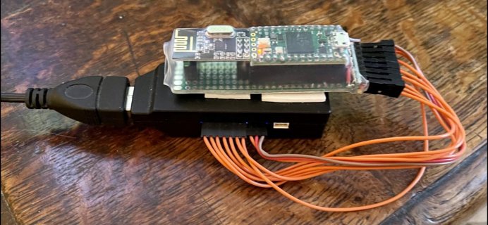

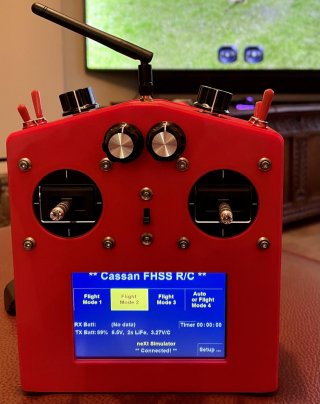

I’m developing a full featured radio control system for models and I’m wondering if anyone else is interested.
I’m using Teeny 4.1 in the transmitter, and a Teensy 4.0 in the receiver. I use a clone version of the nRF24L01+ transceivers, which is screened and
Much more powerful than the original, giving a range of about 2 kilometers.
The features I’ve implemented so far are:
8 channels
4 flight modes
User definable 5 point curves on all channels and modes.
FHSS with my own method of identifying and avoiding busy channels in real time.
16 mixes
99 model memories
TX Modes 1 and 2
Timer
Binding
Full waveband graphic scanner.
Telemetry
Four Definable three-way switches.
GUI on a Nextion 5” screen.
PID gains editor - on the transmitter.
So far, I’ve flown some planes and a quadcopter with it. No problems.
I’m now refining the PID stabilisation because I want it to be also a flybarless system for helicopters.

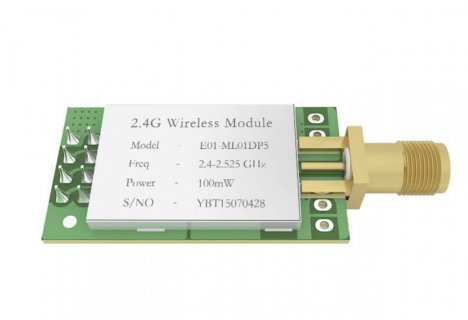

I did a series of range tests after buying many of these nRF24L01 transceivers from many sources, and making them ‘plug in’ to female headers on my circuit boards. I quickly learned that they vary enormously in several ways. Almost all of them work ok at very close range. Some fail after only a very few yards. Some go on working at 2 km. I have attached an image of my preferred type. These are encased in a metal screen. Here’s a quote from their marketing specifications:

My tests confirm a real-world range of about 2km which I think is plenty for line of sight rc models. They are very cheap, so I have bought dozens. Production seems inconsistent probably because they’re so cheap. So I suggest test each one. Several I have thrown into the bin.

What bandwidth do you actually need for this - the nRF24L01 only supports 250k/1M/2Mbaud, so its sensitivity is correspondingly poor.
Sensitivity increases with narrower bandwidth, so if you only need 25kbaud (for instance) and use a 25kbaud transceiver you are likely
to get more like -105dBm sensitivity, allowing more range (or less transmit power: 10dBm is the max legal TX power for 2.4GHz in the
UK I believe).
My preference is for lower frequency ISM bands where you get the advantage of more antenna gain (proportional to square of the
wavelength in a LoS link). Thus 20dBm at 2.4GHz is roughly equivalent to 5dBm at 433MHz, all else being equal - this effect is
purely due to the antennas being longer for lower frequencies. (All assuming quater-wave antenna).
