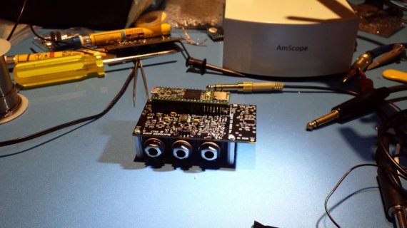

Sorry for the lack of updates guys. Last month has been crazy as I nearly changed jobs (and countries!). In the end, I'm staying where I am and it's back to work on the Teensy Guitar board. I've spent the last week assembling and testing a proto. Here's a summary
- power supply circuits all appear to be functional
- schematic was missing DC blocking capacitor on preamp feedback paths (oops!)
- analog AUDIO IN is passing to DRY OUT, and to AUDIO OUT via Teensy Audio Library (TAL)
- USB audio from PC passes to AUDIO OUT via TAL
- USB audio from AUDIO IN to PC via TAL
What's next?
- populate and test the MIDI circuits
- populate and test the SPI memories
- populate and test the external power supply circuit
- evaluate noise performance

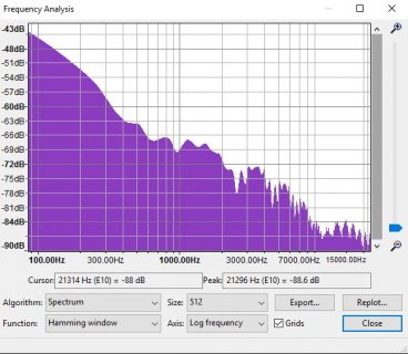

I am working with your design(except that RA3=RA4=1M), but I've got much noise from that channel, Do you have an idea why?
This is the Piezo connected straight to the LINE-IN
This is the Piezo connected to the buffer you designed (maybe because I built it on a matrix?)

MIDI Circuit - confirmed working!
SPI Memories - confirmed working!
External power - confirmed working!
Noise Performance - in progress!
After disabling the HP filter in the codec (similar problem to SGTL5000 board) the self-noise performance is very good ( > than 110db at low frequencies and > 125db at the higher frequencies).
I'm going make a convenience library for the board utilizizing components of the Audio library and put some demo code on github.
I will also start working on Rev 2 of the PCB to address some minor changes I'd like to make after characterizing.
