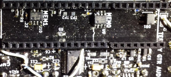

Good! So I need a 9V to 5V converter to get independed power. Another question: is there any picture, which shows, how the mem chip should be orientated? The silk screen shows just a rectangle.
I'll get a picture up showing the Pin 1 orientation tomorrow.
Here's a photo from one of my early protos, both mem chips are oriented the same way. Pin 1 is a circular depression on the chips installed in the photo.
