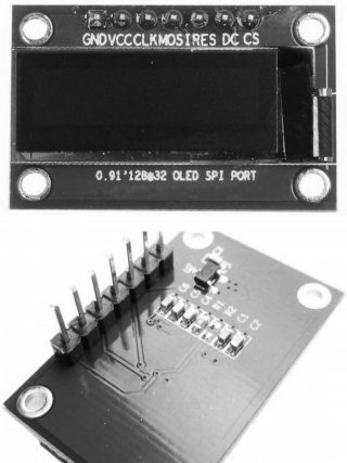

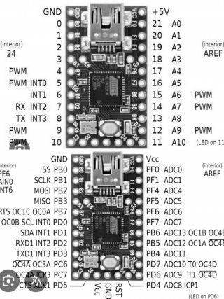

unfortunately I can't get an image on my OLED display 0.91 SPI with the test code attempt from adafruit ssd1306. It should be connected to a Teensy 2.0 short version. I currently have it connected like this: gnd to gnd, vcc to vcc, clk to pin1, Mosi to pin 2, dc to pin 4 and cs to pin 0. Can someone confirm that the wiring is correct. I reconfigured the pin configuration from the test code for my purposes but I don't get a picture. Does anyone have an idea?

Can you provide a photo of this display module. Are you missing Reset pin, Backlight voltage pin?

Sure in Attachments i put picture of Display from front and back. And pictures from teensy2.0

It appears you did not connect Reset to Teensy GPIO pin.
This Teensy is 5V. Is your display 5V compatible?
According to the manufacturer's description, this display can be operated with both 3.3 and 5 volts. The reset pin can be omitted; this is only necessary if the display freezes during operation. So it should also work without a reset pin.
The display can be powered from 5V because it has a voltage regulator to drop 5V down to 3.3V which is needed to power SSD1306. The processor interface, in this case SPI, can only drive 3.3V as a logic HIGH into SSD1306 or else you'll damage the chip. Teensy 2.0 drives 5V unless modified for 3.3V operation (also means slowed down to 8MHz cpu clock).
You need to have voltage level shifters to interface with this display.
And, if you don't connect Reset pin, then at the very least, tie Reset to logic HIGH as indicated in chip datasheet. AdaFruit driver is likely toggling Reset to get SSD1306 into a known state. You should hook this up to Teensy (with logic level shifted to 3.3V along with other interface signals).

Why do I need a voltage logic shifter if the display already has a voltage regulator implemented in the form of a resistor?
Where should the reset pin be on Teensy2.0 pin0 or pin3?

A pair of resistors can act as a voltage divider. Does the display have this for each of the SPI signals?
Reset signal can go to any spare GPIO pin.

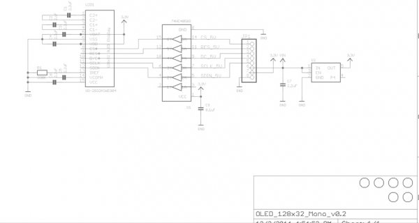

Sure in the attachment i put the schematic

Sorry the second one in this attachment suites more to my Display.
Depends on which library you're using, and for libraries like most of Adafruit's, can also depend on how your program creates the instance. Many of those libraries can use any digital pin, where you just tell it which pin. But again, this depends on which library and exactly how your program uses that library. Can you understand how we're unable to answer your questions asking for specific help when we don't know enough information about what software you're using?

A resistor is already implemented in my OLED display, which reduces the voltage from 5 volts to 3.3 volts. I also use a Teensy 2.0 short version there is a Mosi connection according to the data sheet at pin 2 and a serial connection according to the data sheet from pin0 to pin4. I also only have to use these because my teensy sits on a specially manufactured board which taps pin0 to pin 4, a total of 5 connections for the screen when adding GND and VCC we have total Pin Layout 7 for spi
Please remember we can't see your custom PCB over the internet, unless you show us. We can't see this unusual display which incorporates "A resistor is already implemented in my OLED display, which reduces the voltage from 5 volts to 3.3 volts". The photo in msg #3 seems to have only 1 resistor. The schematic in msg #10, which looks like it's probably the display, doesn't seem to have such voltage reducing circuitry for the data signals. I do see a buffer chip, not resistors, in msg #9, but how this really connects to everything isn't clear (at least to me).
Best I can say is it really ought to work if you just run Adafruit's default Software SPI with the pins connected through level reducing circuitry like a buffer chip or resistor dividers of low enough impedance to handle the signal speed.

Thanks for posting the schematics images.
It's clear the schematic in msg#10 represents your LCD module shown in msg#3.
Component U2 would be a 5V to 3.3V voltage regulator. This is the voltage source for SSD1306 chip.
And, this LCD module requires external logic level voltage conversion such that logic levels are limited to 3.3V.
The schematic in msg#9 is a good illustration of how to add external logic level voltage conversion. This would work with your display module.

I understand it better now, I have grilled my display, since I have all the pins directly on Teensy2.0, I have to see a txb0104 image for every single pin, which could be the solution of course with a new display
