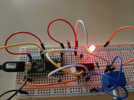

The MicroChip Digipots (4100 series) Not Responding to My Teensy 3.2
DaveC284
I wrote the attached code for the Nano, and had the Nano controlling the MCP41xx and 42xx series digipots just fine. It worked well and I kept expanding and adding features until I ran out of programming space. Switched to the Teensy3.2, then had lots of space, which allowed me to add a user interface for controlling the digipots. I thought I successfully tested the control of the digipots using the Teensy at some point, but in my latest test, nothing was happening. So I uploaded and re-tested using the pre-User Interface version (attached). It's the same Nano code, only recompiled it for the Teensy.
I have confirmed that the digipots are receiving all 3 signals properly: 1) Chip select via the demux, 2) 16 pulses of clk, and 3)the concurrent 16 pulses of data. SPI Data is only transmitted when there is a change - not continuously. I have one dual-channel and several single channel digipots and none of them are responding. They are all receiving all 3 signals.
I attached the .zip file of the code. I use 4 address pins to a 4-to-16 line demux chip (74xx154) to address several other SPI devices. Also attached is the 2 of 3 pages of project schematic.
It's possible that I may not have configured the digipots correctly. It worked for the Nano. Why not the Teensy3.2?
Any suggestions?
Thanks,
Dave

Hi Paul,
Thanks for the suggestion. I should have mentioned that I've tried that too, and it didn't make any difference.
If you think of anything else, please let me know. As best I can tell, everything should be working. I was hoping it would be something silly I had done to mess things up.

Hi Foxhood,
Thanks for suggesting the signal levels. I verified the data sheet and it said that anything >.5V was a high. So, I think we're good there.
From your forest comment, I decided to strip the program down to just the Teensy and the MCP41xx digipot code, but except for the chip select, I can't get even the simplest function (on-board LED) to work.
Features:
1. I've got an LED on the CS line - that works
2. Digipot Reg0 is adjusts the intensity of/for an LED
3. Digipot Reg1 adjusts the input to an op-amp
4. A pot input into A14 (phy pin 33) used to control both registers concurrently
5. Then added short code to control the on-board pin 13 LED using the same anal-pot. Even that doesn't work!
Both the LED and the op-amp input are dependent on the manual pot input.
I know the pot varies properly - I can measure at the A14 input
SerMon does not work
And I'm getting no response from the LED. And yes, it is wired in correctly.
Obviously, I'm doing silly, stupid stuff.
New, streamed-lined script attached.
Thanks,
Dave
What voltage are you supplying to the digipot?
The logic inputs require <0.3Vdd and >0.7Vdd for low and high, ie <1.5V and >3.5V if powered from 5V, so these chips are
not 3.3V compatible if powered at 5V. Nowhere in the datasheet does it mention 0.5V, no idea how you got that?
Note the SPI clock frequency is a maximum of 10MHz (5V supply, not daisy-chained), or 5.8MHz (5V supply in daisy-chain
configuration). For 3.3V operation these will be considerably less, perhaps 4MHz and 2MHz are safe values to assume, as CMOS is
always slower at lower supply. Thus your SPI settings at 2MHz should be good, I suspect the voltage thresholds might be the problem
if running them at 5V.
SPI.beginTransaction(settingsA); //Since we only have a single SPI settings, don't need an SPI.endTransaction();
SPI.begin(); //Initialize SPI
Use SPI.begin() before SPI.beginTransaction().

Ok, some good news here. Switching SPI.begin() before SPI.beginTransaction() fixed a couple things:
1. SerMon now works.
2. The code is reading the analog pot input and reported to the SerMon window.
3. The CS LED to the digipot is irratically flashing, which tells me the if loops works.
What's not working is the LED on the digipot. Maybe the pull-up R's will fix that? Do I need a level translator?

Ok, some more good news. The digipot LED is at least glowing at mid-range where it defaults to with no new value in on-board EE. I thought the LED was wired correctly - it was not. Now having a glow, tells me it's now wired correctly, but not receiving a new SPI input.

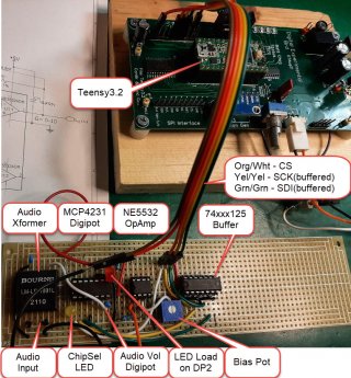

So, I went back into the data sheet and extracted images of the data I thought was relavent. Maybe I'm reading it wrong, but check out the 2 pgs of data I found. See: Digipot Data Taken from MCP4xxx...
I would still like to know why I can't get the SerMon to print or the on-board pin-13 LED to work. The USB port connection is fine.
Ah, I think my search for "MCP41xx datasheet" took me to MCP41xxx as a first hit rather than MCP41xx, which are different. A precise part number is always a better starting point for a datasheet search...
Hi Paul, Mark T,
Just in case I wasn't reading the data sheets correctly, I inserted a 74AHCT125 buffer (level transceiver) in the between the Teensy and the digipots on the SCK and SDI lines. It did not make a difference. I am satisfied it's not the circuit HW. It's got to be the code.
Any more suggestions?

Hi Paul, Mark T,
Attached is the schematic of the dual-digipot(MCP4231) test brd and a captioned pic of the digipot test brd.. Thru one digipot I want to test an audio signal. On the other side, I'm using the digipot to control the current thru an LED.
I have a CS LED that flashes for any value (not a difference value like the code is written) > 2, so not sure what is going on there.
I have confirmed that near-5V signals are reaching the SCK and SDI inputs.
If you need any additional info, pls let me know.
Thanks in advance for all your help.
Thanks,
Dave
  • Schematic_Teensy & Digipot Audio Test Brd_2021-11-10 (2).pdf
In your schematic, I don't see any connection to pin 14 (VCC) on the 74AHCT125 chip.
The schematic seems to show a 20 pin ribbon cable. But in the photo I see only 5 wires.
Your message says you're using MCP4231, but the schematic says MCP4241-103.
Looks like Teensy 3.2 is in a socket, and the MCP4231 chip is DIP package also in a socket. So perhaps for a simpler test, you could unplug Teensy 3.2 and the MCP4231 from this complicated circuitry and put them both on a solderless breadboard without any other stuff (other than wires)? The nice thing about breadboards is they (usually) photograph pretty well, so we can see how the wires are really connected. We can help you much better if we can actually see the wiring, and if the wiring is as simple as possible.
For simple testing, I'd suggest connecting just power and CS,MOSI,SCK directly from Teensy to MCP4231, and connect the pot A terminal to GND and B terminal to 3.3V, and connect a voltmeter to the W terminal, so you can directly observe the result.
Hi Paul, Mark T,
I did what you suggested, I stripped the circuit down to just the Teensy 3.2, the MCP4241 digipot, and manual input pot. Attached are three files: 1) the schematic, 2) pic of the prototyped circuit (w/LEDs), and 3) the revised sketch.
There are 2 LEDs in the circuit: 1) a red load LED attached to the 10k controlling digipot, and 2) a white LED on the Chip Select line. The CS line shows when data is transmitted.
I am able to control the load LED better, but there are 3 behaviors which I don't have an answer: 1)I'm missing the upper 1/3 of the manual pot range, 2) D6 from the Teensy does not appear to go high, so I'm not getting full brightness, and 3) the CS line is taken low every loop around even when I'm not adjusting the pot - I have it coded so it only sends data when there is a change of the pot.
I do a conversion from the 10-bit analog input to the 7-bit digipot.
I believe I'm not able to extinguish the red LED because I'm only using a 10k pot. I may need a 50k pot. 25k is not available.
I made a 64sec video to show all the behaviors above, if you are able to view it. Will your system allow me to upload a 30MB .MOD file?
Thank you!
Dave
  • Schematic_Teensy & Digipot Audio Test Brd_Sht2_13Nov21.pdf
  • Teensy32_DigiPot_InterDev_Stripped_13Nov21.ino
1) This is not to do with the pot value, you need to give the pot 3.3V, not 5V, so all of the track is useful.
2) Nothing is connected to D6 on the Teensy according to your circuit.
3) This might just be a bit of jitter on the analog input - even though you have a capacitor there the ADC
is relative to the supply which may have enough noise on it to add a few LSBs of jitter.

Hi MarkT, Paul,
1. That makes sense. So, I attached the high side of the pot to the 3.3 pin. In the video, ignore the comments about the 1 o'clock position.
2. Clarification - I should not have called it "D6". What I was referring to was the 6th bit (2nd most sig bit) of the SPI serial string - easily seen in the video.
3. You're right, noise on the input affects the lowest couple of bits, but that's not the issue. Pls see the video.

Hi Paul, Mark T,
Any thoughts as to why the 6th bit is not being output (as it appeared on the DSO) from the Teensy?
Also, I measured to the current thru the load LED and at the low end, there's still ~675uA current. Apparently, still plenty to make the LED glow. I'm guessing I'll have to use a 50k pot.

Paul, Mark T,
After trying the code in a different Teensy (no change), I re-counted the bits that are working. All lower 7 bits are being transmitted and received by the digipot. That tells me that the MSB is not being transmitted.
Am I looking at this correctly? Is there something I'm not doing properly?
