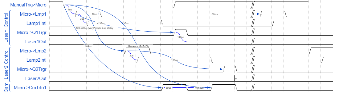

8 signals on a microseconds scale, repeating at 15 Hz.
There's two sets of lasers which need warm-up times (~135us) which work to illuminate a scene.
There's a camera which needs an 'expose' signal.
There is an analog-in (10kpot) that I'd like to use to vary the timing between the two exposures (2nd illuminator and 2nd frame exposure).
The manual trigger is on an interrupt with a debounce in the callback.
Attached is a timing diagram. Sorry, it's a little busy.

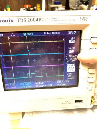

15 hz is good. The whole pulse train crunches along at a very periodic rate:14.997.
Signals happen in proper sequence: exposures happen over the strobes.
Jitter is low enough, looks like 1-2us over the 200us of a pulse train.
What's still broken:
Each restart, I have an indeterminacy due to the way I'm initializing the timers. It's amazing that
it works as it does: (8)64 bit counter screaming along at 98MHz lining up most of the time. but for example, a requested 98us delay measures to 108, 122 or 146. Might work in practice, but it's unsettling.
Also, the pulse train degrades after multiple manual interrupts. That's not how it will be used,
but it is a sign of instability.
When I try to do analog sampling of the duration variable, things get unstable a bit more quickly.
