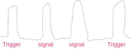

Hello,
I am new in the microcontrollers world so excuse me if I ask stupid things.
I have a Teensy4.0 and I want to use it to measure analog data with the following structure:
The time between trigger and trigger is constant and the time of the signals between triggers can change. The width of the signals also change. Once the second trigger finishes the loop starts again.
I would like to measure the time and width of all the signals.
Right now I am feeding the signal in one of the analog pins and I see the signal in the serial plotter. I am using the following code:

My questions are:
- Is there any better way to measure this type of signals. I would like very good timing precision and measure fast
- How should I decide the better baudrate in my case? I am not pretty sure how it works, I read that if you are connecting teensy through USB the baudrate doesn't affect the measurements but I don't know if it is true.
- How can I save arrays of the measured data and calculate the times and widths of the signals while I am measuring?
- Can I somehow calculate the Fourier transform of the measured data in order to obtain the frequencies of the signals?
Thank you in advance.

// https://forum.pjrc.com/index.php?threads/timing-measurement-of-analog-signals.76685/post-360758
// Wire Pin #22==A8 to Pin #23==A9
#define MAX_FILL_CNT 20
uint32_t seeTimes[64][3];
IntervalTimer myTimer;
uint32_t usDelay[4] = { 2, 5, 10, 15 };
volatile uint32_t myCnt = 0;
void catchTimes() {
  seeTimes[myCnt][0] = ARM_DWT_CYCCNT;
  seeTimes[myCnt][2] = micros();  // not enough resolution as it runs 3+ times per us
  seeTimes[myCnt][1] = digitalReadFast(A8);
  myCnt++;
void sendTimes() {
  if (myCnt < MAX_FILL_CNT) {
    digitalToggleFast(A9);
    myTimer.update(usDelay[myCnt % 4]);
  Serial.begin(1);
  pinMode(A9, OUTPUT);
  pinMode(A8, INPUT);
  Serial.print("Hello World CPU_Hz==");
  Serial.println(F_CPU_ACTUAL);
  delay(2000);
  Serial.println("Starting ...");
  attachInterrupt(A8, catchTimes, CHANGE);
  myTimer.begin(sendTimes, usDelay[3]);
uint32_t setCnt = 0;
  if (MAX_FILL_CNT == myCnt) {
    for (int ii = 1, jj = 1; ii < MAX_FILL_CNT; ii++, jj++) {
      Serial.printf("[%5d] %2d == %d CLK cycles\t state=%d\t %d us\n", setCnt, jj, seeTimes[ii][0] - seeTimes[ii - 1][0], seeTimes[ii][1], seeTimes[ii][2] - seeTimes[ii - 1][2]);
    Serial.printf("\n");
    setCnt++;
    delay(1000);  // wait 1 seconds before next set
    myCnt = 0;
Output showing this cycling of recorded us's:
[   70]  1 == 8995 CLK cycles     state=0     15 us
[   70]  2 == 1200 CLK cycles     state=1     2 us
[   70]  3 == 3000 CLK cycles     state=0     5 us
[   70]  4 == 6000 CLK cycles     state=1     10 us
[   70]  5 == 9000 CLK cycles     state=0     15 us
[   70]  6 == 1200 CLK cycles     state=1     2 us
[   70]  7 == 3000 CLK cycles     state=0     5 us
[   70]  8 == 6000 CLK cycles     state=1     10 us
[   70]  9 == 9000 CLK cycles     state=0     15 us
[   70] 10 == 1200 CLK cycles     state=1     2 us
[   70] 11 == 3000 CLK cycles     state=0     5 us
[   70] 12 == 6000 CLK cycles     state=1     10 us
[   70] 13 == 9000 CLK cycles     state=0     15 us
[   70] 14 == 1200 CLK cycles     state=1     2 us
[   70] 15 == 3000 CLK cycles     state=0     5 us
[   70] 16 == 6000 CLK cycles     state=1     10 us
[   70] 17 == 9000 CLK cycles     state=0     15 us
[   70] 18 == 1200 CLK cycles     state=1     2 us
[   70] 19 == 3000 CLK cycles     state=0     5 us
Thread Title is 'analog signals'.
These examples are using Digital reads as noted - unless/until the "analog" value crosses the threshold midpoint there will be no recorded change.
I edited the example to SELF cycle the output with analogWrite and it is Very TRICKY - of course the anaolog write is PWM and there are no smoothing capacitors and analogWrite is slower?
The times are all reasonable and consistent - but not clean and right like with digital.
Not much info was given about the expected LOW and HIGH times and the nature of the analog signal - this may be the wrong approach ...
