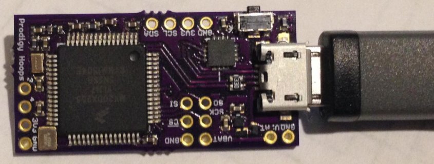

I was challenged to make as narrow a Teensy as I could so as to fit inside a "standard" 14-mm-ID hoop. I easily got to 15.4 mm and decided to stop here for a test run.
It is of course a stunted Teensy since it has only those ports exposed that are required for the application. Getting to 14 mm will be quite difficult; I will have to make more use of the back of the board and possibly replace the side button with a top-mounted button. I have a battery charger and motion sensor on the back so i am running out of room. The last 10% will require 90% of the effort. The good news is it might not be necessary, as this size might be small enough for the use case. If not the tiniest Teensy, it surely qualifies as one of the cutest Teensy's ever!
