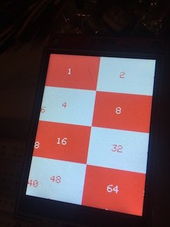

This is part of my first project.
I'm trying to get my tft touchscreen to work, and it isn't drawing as expected. I'm expecting with the following code, to get 8 rectangles with the labels from the array "lengths" on them. But there seem to be a number of labels appearing that should not be there, including some that shouldn't be anywhere (like "40" which has a zero in it for instance), and some dots of the beginnings of something on the edge of the screen..

yet what I'm getting is:
LOL!
How embarrassing.
I copied the syntax for a for loop from another place without checking. Doh!
thanks :)
