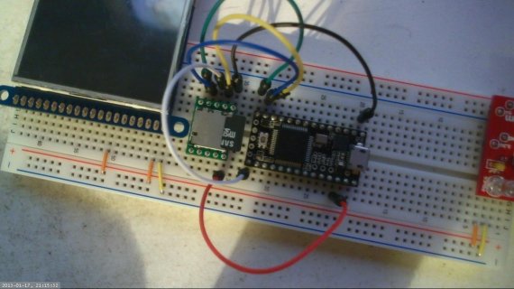

So this chunk of code is supposed to take incoming characters from the USB port and save them 400 at a time to a text file on a micro SD card. (Micro sd adapter+teensy 3.0). So, I don't know what I'm doing wrong, but it doesn't seem to work. My cohort tested the our hardware setup with one of the built in examples for the SD library, so we know it's not the hardware. Any idea about what I might be doing wrong? (the ss conector is on pin 10, which is Serial 2 on the teensy 3.0).

Well, the code compiles and runs without error but whenever I check the SD card, there is nothing saved on it. The SD adapter is connected on pin 10, and I was of the understanding that pin 10 is serial 2. Also, I set up my breadboard like the one in this picture.
It is probably unrelated, but wonder about the line:
      char text[400];
Right after the myfile.close() ?
Since it is defined after the other usages, it's scope probably does not interfere? But I would sure remove it and see if it helps.
Edit: Also, on another thread I have issues reading SD card on some of the Adafruit display cards. The call to SD.begin() is failing. You might want to check the return value here and see if this is succeeding for you.
