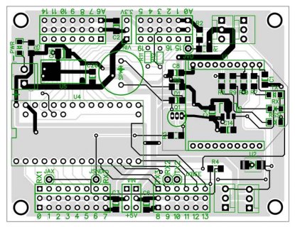

So, I thought it might be fun to have a teensy setup with an adapter board that has all of the things I like, for a simple robot controller board, so I started playing around with diptrace, and laid out a board, that has the Lynxmotion/Basic Micro form factor (3" x 2.3") as to make it fit on several of my robots.
It has a power buss, with a 5v and 3.3v voltage regulator (not sure if it was wise to leave XBee powered directly from Teensy), XBee, Speaker, 3 pin connectors for most of the IO pins (punted on the ones on the bottom), 4 AX-12 connectors, with jumpers to enable/disable the different things, possible PUs for SCL/SDA... Thought it was far enough along to try it out, so will have a few fabricated by Osh Park... Will see how bad I screwed up.

Thought I would mention, that I received my fabricated v .01 boards back, plus a couple of new green Teensy 3.1 boards from pjrc and parts from digi-key and yesterday I assembled the first one. Now starting to play :D
Already know a few things I would do different if I do a new version, like bigger power connector. Maybe cut the USB power connector and put jumpers on board to select if I want the board to be powered by USB or not... But so far it is working.

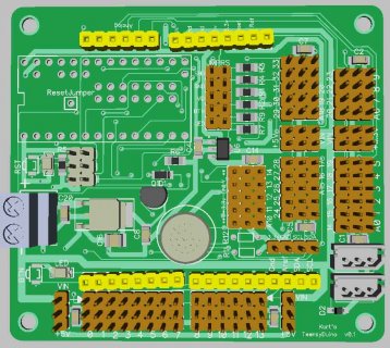

Quick update here: I have been playing around with the board and having fun. Currently on a rover, so I can test out some other stuff like my version of the roboclaw library. Also updated the Arduino Playstation 2 controller library to work. Having a slightly different board fabricated. Actually trying out OSHPark and Seeedstudio on fabricating a few again...
But while I was at it, there were a couple of people mentioning that they would like Arduino Header support. So while waiting for a few things, I started hacking away again in Dip Trace. and have a version that might work:
More details up on Lynxmotion Forum (http://www.lynxmotion.net/viewtopic.php?f=26&t=9119&start=15) as well as Trossen Robotics (http://forums.trossenrobotics.com/showthread.php?6632-PhantomX-using-a-Teensy-3.1/page8)
Not sure yet if I will fabricate any of these, but having fun!
