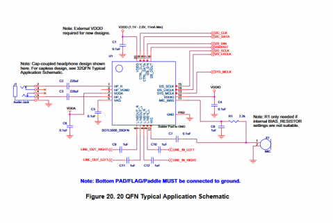

Hello, I used the information given from the Audio System Design Tool and the SGTL5000 datasheet to try to make a biquad I2S shield, and using Eagle to design the board. My design came out like this and I ended up getting them produced by JLCPCB, but they're not working. I have a picture below of the schematic, only showing one of the SGTL5000s next to the wiring for the Teensy 4.0:
As far as I can tell I followed the exact recommended schematic to a T, as shown here: (Left off the headphone jacks cause I didn't really wanna use them):
Does anybody seem to know why mine isn't working? I uploaded a basic passthrough code and it works with my normal Teensy I2S shield. I also didn't know what it meant by "new designs" on the VDDD pin so I just left that off, it was really vague even in the text description on the datasheet.
I also realize it shows polarized caps but the ones I used were not polarized, I can assure that

I guess now looking at other schematics I can see that not hooking up the VDDD is where the problem lies. Guess I'm gonna have to get them rebuilt
You may find you have other problems, too… I’d suggest you look at Paul’s known-working schematics on this page.
It’s not clear what you mean by a “biquad” audio shield (biquad is often used as an abbreviation for biquadratic filter). There are clues suggesting you’re wanting to make a 4-in 4-out shield, so I’m going with that. If I’m wrong, you may want to clarify matters…
  • you’ve not connected the SGTL5000 control bus to the Teensy’s I2C; this is essential
  • you’ve used the 20-pin version of the SGTL5000, which doesn’t have a configurable I2C address. This makes using two of them a pain, at best. Do yourself a favour and put 32-pin ones on, with their ADDR pins wired to give them different addresses
  • fit I2C pull-ups
  • you seem to be aiming to use a Teensy 4.0 - be aware that pin 32, needed for outputs 3 and 4, is actually a pad on the underside of the PCB. Your partial schematic makes it hard to guess your intentions…
As a rule of thumb, if you’re not sure what a pin does, you need to do more reading until you do understand it. Failing that, be sure at least to connect it to a test pad so you can modify the manufactured board. It’s also a good plan on a first board spin to make sure all signals are routed so you can cut the trace and re-wire it correctly, if needed. It’s rare to get anything other than the simplest board 100% right first time, but expensive and frustrating if you can’t even attempt to fix it :)

The bit about the pin 32 I do at least have covered, I just put a via on it to run a wire to the underside of the 4.0. I did this so I could do it with a 4.0 or 4.1 without changing the footprint. But obviously I have a lot of other problems haha. I've had a fair bit of luck on the past barely knowing what I've been working with and having it work out so far, knew my luck was gonna run out, I thought I had cleaned enough to make it work. Also is it not called biquad in the Audio System Design tool? I just used the name I saw there for the option of hooking up two Audio Shields. Regardless yeah it was probably a bad idea for me to jump the gun but live and learn, thanks for spending the time on helping me out!

Nope. There’s an AudioFilterBiquad, described as a “Biquadratic cascaded filter, useful for all sorts of filtering. Up to 4 stages may be cascaded.” Then there’s AudioInputI2SQuad and AudioOutputI2SQuad which you’ll be using for your dual audio shield.
I just looked, and it appears JLCPCB have at best limited numbers of the QFN32 version of the SGTL5000 in stock. But the quoted lead times don’t look too bad, 9 or 10 days. Never had to contend with this so no idea if that’s realistic.

Ah yeah I got them confused, cause I was learning all about digital filters and got quad confused with biquad. I'm an EDM producer of more than 14 years and only now am I actually learning about the nitty gritty of the digital process of making music, but I guess to be fair the vast majority don't. Regardless, I will have to remake these and your help has made this a lot more of a possibility. Thank you.
