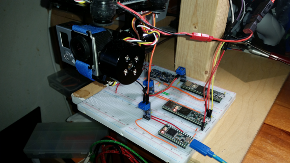

Before getting back to work I incorporated tonton81's new IFCT FlexCAN library into UAVcan. Thanks to tonton81 for all his help in getting this merged and updating his library. I also updated the examples to ensure no bus crashes when banging the CAN bus at loop speeds. This happened with the old library and the new library as well. All changes have been posted to GITHUB master branch.
Using a GIMBAL with UAVcan - Live
The Teensy 3.2 is the main controller and sends serial commands I entered to the node over the CAN bus. The Teensy 3.6 is the Gimbal node and powered from the battery for the Gimbal/controller. Notice no USB cable.
In the demo 4 commands are implemented Pxx for Pitch(deg), R for Roll, Z for return to 0 and L to do a Pitch -16 degrees. Here is quick video of it in action: https://youtu.be/eOAdpgBizgQ. Again this is just a demo of in action. Attached is photo of the test rig.
