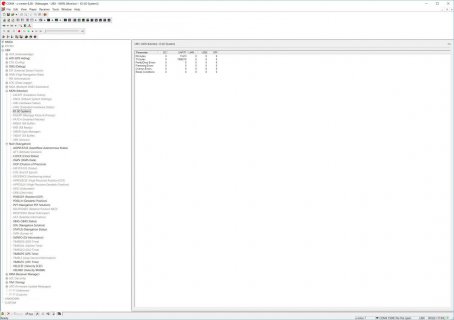

Update #3
Ok so finally i had time to finish up this work-in-progress ver.1.0.2
@ Mike
I hope you still around i did manage to implement the commands CFG-NAV5 (0x06 0x24) and CFG-RATE (0x06 0x08)
Gps.SetNAV5(3, true); //Set Dynamic platform model Navigation Engine Settings (0: portable, 2: stationary, 3: pedestrian, Etc)
Gps.SetRATE(200, true); //Navigation/Measurement Rate Settings, e.G. 100ms => 10Hz, 200 => 5.00Hz, 1000ms => 1Hz, 10000ms => 0.1Hz
The biggest change and challenge was implementing command generator, currently only three commands are using this new implementation.
Because of this the v1.0.1 changing baud rate predefined SetGPSbaud9600() command is deprecated.
The new way:
SetGPSbaud(uint32_t baud, bool) ~ (Parameter, Boolean) = (true) Print Message Acknowledged on USB Serial Monitor
SetNAV5(uint8_t dynModel, bool)
SetRATE(uint16_t measRate, bool)
I am also including example2.ino, hope this will explain the commands syntax without too many questions.:eek:

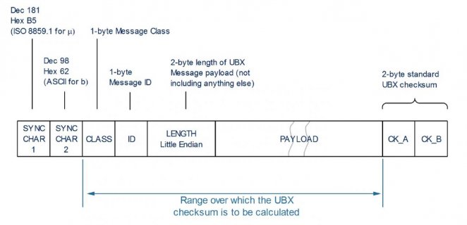

  Identify the packet Class in receive message
  Identify the packet Message ID in receive message
  Identify the packet 16Bit Message payloadSize
  Fixed the checksum calculations, now it's based on*the*received message payload.
  This fixes the compatibility issues between NEO-M8 and NEO-M7-6 GPS series.

void UBLOX::writeCommand(uint8_t CLASS, uint8_t ID , uint8_t PayloadLen0, uint8_t PayloadLen1, uint8_t Identifier, uint8_t reserved0, uint8_t Par0, uint8_t Par1, uint8_t Par2, uint8_t Par3) const {
  const uint8_t HeaderLength = 2; // 2 synchronization characters: 0xB5 0x62.
  const uint8_t CLASSandID = 2;   // 1-byte Message Class field and 1-byte Message ID field
  const uint8_t LenF = 2; // 2-byte 16-bit Length field
  const uint8_t CRC = 2;  // 2-byte 16-bit checksum
  uint16_t Bit16PayloadLen = (PayloadLen1 << 8) | PayloadLen0; // Combining two uint8_t as uint16_t
  uint8_t DATA [Bit16PayloadLen] {}; // Set up DATA array with size of 16 bit payload length

  // The checksum is calculated over the packet, starting and including the
  // CLASS field, ID field and payload, up until, but excluding, the Checksum Field
  // (CRC) Compute checksum
  // NOTE: @ GPS baud 460800 CRC = 0x0C, 0xBC
  uint8_t CK_A = 0, CK_B = 0;
  CK_A = CK_A + CLASS;
  CK_B = CK_B + CK_A;
  CK_A = CK_A + ID;
  CK_B = CK_B + CK_A;
  CK_A = CK_A + PayloadLen0;
  CK_B = CK_B + CK_A;
  CK_A = CK_A + PayloadLen1;
  CK_B = CK_B + CK_A;
  for (int i = 0; i < Bit16PayloadLen ; i++) {
    CK_A = CK_A + DATA[i];
    CK_B = CK_B + CK_A;

            //                 Header|CL|Id|DSize| MSG Payload                                                 |Checksum|
            // _gpsPayload:[n]       | 0| 1| 2  3| 4  5  6  7  8  9 10 11  12 13 14 15  16 17 18 18 19 20 21 22|23 24   |
            //23:46:54   0000   B5 62|06 00|14 00|01 00 00 00 D0 08 00 00 >00 08 07 00< 07 00 03 00 00 00 00 00|0C BC   |  µb........Ð................¼.
            // >baudRate uint32_t<
            // Little Endian: Hex: 0x00080700
            // Big Endian:    Hex: 0x00070800 Decimal = **460800‬baud

    // Identify the packet 16Bit Message payloadSize
    // It does not include 16Bit-Sync header, 8Bit-Class, 8Bit-ID, 16Bit-Length Field, and 16Bit-CRC fields
    else if (_fpos == 4 ) {
      //Serial.write(c); // USB u-center
      ((unsigned char*)_gpsPayload)[_fpos - 2] = c; // least significant byte (LSB)
      _fpos++;
    else if (_fpos == 5 ) {
      ((unsigned char*)_gpsPayload)[_fpos - 2] = c; // most significant byte (MSB)
      _MSGpayloadSize = (_gpsPayload[3] << 8) | _gpsPayload[2]; // Combining two uint8_t as uint16_t
      _MSGpayloadSize = _MSGpayloadSize + 4; // Fix for (CRC), Add 8Bit-Class, 8Bit-ID, 16Bit-Length Field
      _fpos++;

Ok so I've been running stress test of this 1500000 baud rate.
Basically i used u-center and enable all possible msg. Combination (NMEA, UBX, Monitoring msg. Etc)
So far so good
Now GPS UART1 @ 1500000 baud rate
TX bytes 35001890
EDIT:
TX bytes 43863123
Just a quick note this is all done on breadboard with 5-inch wires between GPS and Teensy 3.5 on serial 3
Between these changes and the SPI_MSTransfer libraries things are going to get interesting fast :)
Yeah it does look interesting so far.;)
I will try faster baud rate when i have more time.
TX bytes @ 89576358 no errors

is there a reason why you make a 16 bit but print out the 8 bit data instead?
I'm assuming you looking at my DEBUG(), i'm only grabbing the payload length field which is 16-bit from the received message which is stored in _gpsPayload array.

UBX Frame Structure
This is how it prints the array data
  CK_B = CK_B + CK_A;
  CK_A = CK_A + ID;
  CK_B = CK_B + CK_A;
  CK_B = CK_B + CK_A;
  CK_B = CK_B + CK_A;
    CK_B = CK_B + CK_A;
      // prevent _gpsPayload[_payloadSize] array overrun error, currently set @ 150
      if (c < _payloadSize) {
        _fpos++;
        Serial.print("_gpsPayload[_payloadSize] array error:"), Serial.println(c);
        _fpos = 0;
      // CLASS field, ID and payload, up until, but excluding, the Checksum Field
      if ( (_fpos - 2) == _MSGpayloadSize ) {
        calcChecksum(checksum, _gpsPayload, _MSGpayloadSize);
      else if ( (_fpos - 2) == (_MSGpayloadSize + 1) ) {
        if ( c != checksum[0] )
          _fpos = 0;
      else if ( (_fpos - 2) == (_MSGpayloadSize + 2) ) {
        _fpos = 0;
        if ( c == checksum[1] ) {
          return true;
      else if ( _fpos > (_MSGpayloadSize + 4) ) {
        _fpos = 0;
  return false;
