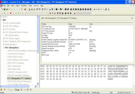

Problem UBLOX Lib with Arduino Nano

Led flashes if gps.readSensor() == true. Led flashes sometimes. But often do not catch fire. This means that the library does not accept the package from the GPS.

Packages as in my opinion are broadcast through Arduino without problems. Ublox-center accepts and decodes them correctly. Full packet length of 100 bytes.
09:20:23 R -> UBX NAV-PVT, Size 100, 'Navigation PVT Solution'
09:20:24 R -> UBX NAV-PVT, Size 100, 'Navigation PVT Solution'
09:20:25 R -> UBX NAV-PVT, Size 100, 'Navigation PVT Solution'
The header is correct, the length indicated is 92 bits = 0x5C - the same too. I can not understand what the problem is the second day! Please help!

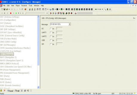

There is only one problem — I can't force M8N to save UBX-NAV-PVT mode in memory. After turning off the power of the M8N, it jumps to UBX-NAV-SOL with the UART1 port turned off. See screen. But packages in the UBX-NAV-PVT format are still transmitted to format continue to be transmitted to the U-Center or to another terminal program TERMITE 3.2 both via Arduino and so on via Uart -> Usb.

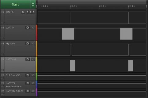

The problem is that at any speeds of 19200, 38400, 57600, everything works if I reduce the transfer from NEO to 240 bytes. I experimented throwing away SOL or STATUS + DOP.
I came to the conclusion that there is not enough buffer for Serial RX. I increased the buffer from 64 by default to 320. That didn't help! Please advise what I can try to do?
I also give a picture - channels from top to bottom: parsing, UART RX, my code, UART TX.

@Gennady1990 - what Teensy and what Serial port # is the GPS connected to where the buffer was increased? OR is this still on a Nano?
in nano! but problem not in speed!
Just a question to the hardware in use - even on Teensy there is a diff between Serial1/2 and Serial3.
When I was working with @brtaylor on T_3.5/3.6 the baud was 100K>900K baud and worked quickly to keep the PVT (?) message flowing. Not sure we did messages that large - the rate was typically 5/sec rate - but the faster baud worked.

Today I experimented with the messages in the package. NEO 57600baud, 5Hz. The working version is the following and the only one.
UBX NAV-SOL, Size 60, 'Navigation Solution'
UBX NAV-POSLLH, Size 36, 'Geodetic Position'
UBX NAV-VELNED, Size 44, 'Velocity in WGS 84'
Total 240 bytes.
In this order, NEO builds them.
I add MON-HW2 long 36 byte. He stands in front of SOL on some time lead. But its frequency of appearance is 1 Hz. At this point, the parsing does not work. After that, I removed MON-HW2, but I inserted the message DOP 26 byte. It fell AFTER the POSLLH message. With him, the parsing also disappeared. At lower speeds 38400, 19200 the same.
I noticed that after pressing the reset button, the first parsing takes place under any conditions.
It seems that with a packet of more than 240 bytes, some kind of buffer overflows.
I do not know what to do anymore ((((
