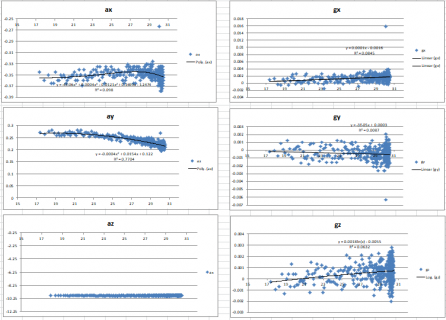

Was busy this morning looking at a theory I had on the temperature impact to the gyro and accelerometer. I would say yes there is based on the attached charts. Gyro can probably be adjusted if there is no motion and running a short gyro cal. Accelerometer is another story.

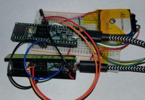

Advance Note in case it helps wiring and setup as the transition is made.
Using SPI0 on both I have this working as T_3.5 Slave :: T_3.6 Master > Connections
[U]T_3.5 :: T_3.6 > Connections[/U]
GND:: GND > GND
14  :: 14 > SCK
12  :: 11 > MOSI
11  :: 12 > MISO
02  :: 15 > CS
and a pic - the T_3.0 wires still coming up to Serial1:
I figured the picture would make up for my possibly writing it badly. tonton81 is running Master off SPI2 bottom pins.
The Master uses standard config - the Slave is hardcoded to function pins AFAIK.
