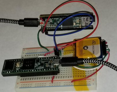

Hi Don. Think you can just hook say SerialX to SerialY on the two teensies for communications and then just use the USB ports on ports. Either use the Arduino serial monitor or use putty for the one you want to use to transmit commands.
I tested this to work - hopefully the comments below are right to make it usable for others? One sketch below - under "#if 0" are the parts needed for the Teensy under test to Bypass the Tviewer ownership of the USB port. The IMU INT pin will have to come off Pin 1 to use Serial1.
If you don't have a Second Teensy - buy some more: An FTDI adapter can work - though they won't run at 2 Mbaud. Teensy can run faster - but too much output will overwhelm the default Serial# buffers if not careful, though Proxy Teensy will have no trouble keeping its end empty.
Second Teensy PROXY { BBoard is T_3.6 with onehorse MPU9250 on under pads, GPS is Serial2 and PPS is Pin6, second Teensy is Serial1 with pins 0&1 crossed with GND connected }:
// For second Teensy connect USB to SERMON (TyCommander)
// Connect two Teensy GND's and cross Rx/Tx to either Serial 1 or 2 port here and in the other sketch.

I'm taking a step back right now and trying to send commands from one T3.6 to another T3.6 via Serial, using two different computers. Should be simple, but this is new to me, so am wiring a simple test up now. This will allow me to change EKF parameters on the fly (on one computer) and see the results via TelemetryViewer (on the other computer). At least I think so...
Hi Don. What you are doing should work, I don't see why it should. Principal is the same as what defragster is doing and what I have tried in the past. Only difference is you are on two computers.
I'm now able to send commands from a second T3.6 (via second computer) to the T3.6 with the EKF. So suspect tomorrow sometime I'll be up and running with being able to adjust Q and R in real-time while viewing TelemetryViewer in real-time.

Great News Don, glad that worked out. You could run a second copy of Tviewer there too perhaps alternating with debug - have it show those stats in human form - send CMD to change if desired - then own that port on Mac with Tviewer - disconnect and adjust ... repeat.
I compiled the xxx_EulerV2 code for T_3.6 at 48 MHz and it runs Tviewer and Proxy output at 250 Hz.
I compiled at 24 MHz and the 2Mbaud Proxy output fails - I need to ask about that - but turning that off - 250 Hz output to Tviewer looks to be working!
The math so far integrating and reading 250 IMU data sets per second can run on 24 MHz ( compiled Fastest w/LTO ) - while streaming the Tviewer data out USB Serial for plotting!

#define IMU_ADDR 0x69 // 0x68 // SPI 9
#define IMU_SCL 47 // 0x255
#define IMU_SDA 48 // 0x255
#define IMU_INT_PIN 50 // 1 // 14
#define coutD_BAUD 2000000 // coutD for DEBUG port
#define coutD Serial1 // Serial2
#define GPS_Start 2 // 1 // UBLOX gps(gps_Start);
#define GPS_PORT Serial2 // Serial1
#define GPS_BAUD 460800
#define GPS_AltRx 255 // 27
#define IMU_BUS Wire // SPI
#define IMU_SPD 1000000 // 0==NULL or other

:: includes various #defines, and the Serial Rx_ISR() in some fashion - updated output below
GPS Start bit detect is in some sketch here not shared yet. It might look something like this:
#define GPS_SRX 9  // Must be set to Serial# Rx Pin #
// FASTRUN void GPS_serialrx_isr()
volatile uint32_t GPS_RX_time = 0;
volatile uint32_t GPS_newData=0;
FASTRUN void GPS_serialrx_isr() {
  static uint32_t tt;
  static uint32_t xx = 0;
  tt = micros();
  if ( tt - xx > ((F_CPU / GPS_BAUD) * 30) ) {
    GPS_RX_time = tt; // Start bit transition detected after 'idle' time
    GPS_newData=1;
  xx = tt;
// In setup()
  attachInterrupt(digitalPinToInterrupt(GPS_SRX), GPS_serialrx_isr, RISING);
For IMU the isr() could be altered to do this in some legitimate manner - otherwise the time stamp will vary depending on when the readIMU() gets hit next:
void runFilter() {
newData = 1;
rtk.ts = ((double) timeStamp) /3600000.0f;
Indeed - good we are using alternate hardware configs - would be nice to have a uniform set of #define to quickly make any shared sketch work. Also yes, if done in TThreads - it would take some rework to make it a normal sketch again. That's why I wasn't rushing after seeing that so far everything is running on a 24 MHz CPU.
BTW: Paul confirmed that at 24 MHz - 2 Mbaud is not supported - only runs up to 1.5 Mbaud.
I found the STREAM stuff - use was commented out - I converted to .print for GPS and it works to show GPS parsed data:
        coutD.print(" Lat: ");  coutD.print(rtk.lat,7);
        coutD.print(" Lon: "); coutD.print(rtk.lon,7);
        coutD.println(" ------------------------- ");
Lat: 46.6143829 Lon: -123.6503630 Time: 183678 -------------------------
