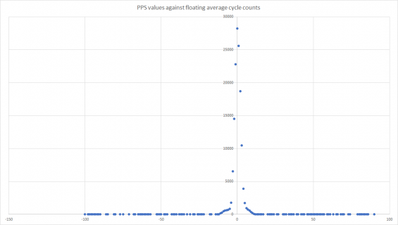

In my quest for a fast unified timer I tapped the Serial receive pin with an isr() to capture the first bit transition of incoming GPS serial message. That time based on F_CPU CycleCounter normalized (?) with the GPS PPS signal gives a fast way to time tag events - GPS reception and IMU data notification (same tap on MPU9250 interrupt gets uniform time). Shows 6X faster than micros() read and will resolve +/- a few dozen nanoseconds rather than +/- a uS.

This shows 30 hours of cycle counts (averaged as the crystal freq moves) on Y against the +/- of the incoming PPS signal on T_3.6 at 240 MHz.
