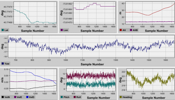

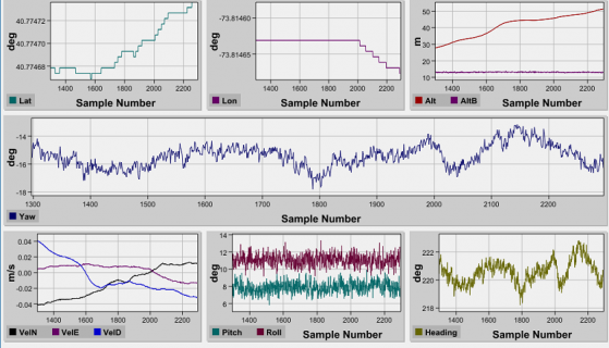

Hi Tim,
Loaded up your code, yes I used code compare. Still missed one thing on first go :)
Anyway here are my observations, not sure if you see the same things:
1. Yaw is a more stable that it was before, now its about +/- 1.5 degrees
2. Pitch and roll - not so much. In previous iterations it pretty stable with minimal variation. Now I am seeing about +/- 1 degree variation in roll and pitch.
See screenshots for 1 and 2.
3. dt is very choppy - can see it as it is printing so I took a look at the loop counter and its all over the place:
