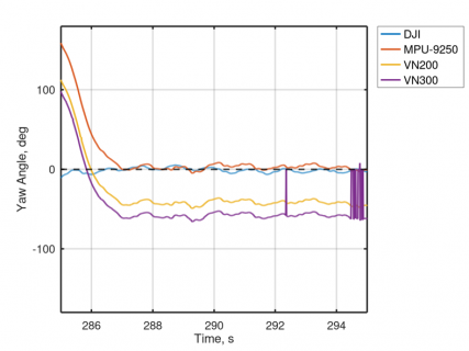

Attached is a zip of the corrected code. It was being used with some CMake build tools, but should be easy enough to get it working as an Arduino library. Requires Eigen.
Yaw tracking has been good while moving. Here is a plot of a test I did where I was walking on a north-south aligned street and compared the EKF results with the DJI A3 flight control system, a VN-200 and a VN-300. The EKF was using an MPU-9250 IMU (hence the label) and a F9P GNSS receiver. The weird data dropouts on the VN-300, I think were due to a specific cable - this test was performed in February and in April, I tried to reproduce the data dropouts to debug with VectorNav engineers, but couldn't reproduce the issue, which is why I think it was an intermittent cabling fault between the Teensy and the VN-300. Prior to this test, all of the filters were warmed up by moving the platform in pitch, roll, heading circles and changing position for about 5 - 10 minutes.

Hi Brian
Sorry was had to disappear for awhile. Interesting that the MPU-9250 gives about the same results as the DJI but the VN-200/300 are off by about 45degs?

Yeah, seems weird - it's too big of an error to be declination. I haven't had a chance yet to do a deep dive into what's going on.
