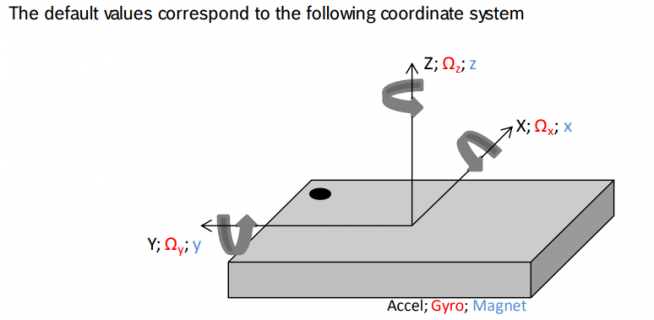

It looks like your z-axis accel is positive up instead of positive down. Your z-axis gyro and mag are also probably not correct. Looking at the data sheet, it looks like by default x is positive forward, y is positive left, and z is positive up. You should test all of your sensor data. You test the accel by rotating each axis in line with the gravity vector and checking the sign of the corresponding accel channel. You can check each gyro axis by inputting a right hand rotation on each axis and checking the sign of the corresponding gyro output.
Would also help to post your application code and the BNO055 library that you're using. I don't have one of those, but it sounds like Mike does.
Thank you for the answer.
According to my system I have already tested that the vertical (z) axis is pointing down, so 9.71m/s2 positive works according the ref.
I’ve already tested all the axis possibilities and I’m getting those random reading for roll pitch and yaw.
The BNO055 data sheet has a diferente reference frames so that’s why I needed to change the orientation to match the most common axis distribution: front positive, right positive and down positive.

For some reason you keep ignoring the BNO055 code that we keep asking Brian and I keep asking you about.
Wont be able to help you much more. Would be nice if you could attach the actual code you are running with the bno055 -- otherwise its just guess work on our part.
Just looking at your BNO055 code it looks like by just using
bno.begin()
the BNO055 is in ndof mode which puts in fusion mode with 9 degrees of freedom where the fused absolute orientation data is calculated from accelerometer, gyroscope and the magnetometer and the default axis orientation is:
Which shows the axes are not aligned according to what @brtaylor mentioned. In addition when you are in fusion mode you will only get data from the sensor when it is moving, If its stationary no data will be generated. Try the examples to see what I mean.
Also you probably should set your accel, gyro ranges.
No, I’m not using that acceleration, I’m using the mode that I’m getting the total accelerations even when the system is stationary, you can see it in the image I posted yesterday. I’m receiving the gravity acceleration plus any other external accelerations due motion.
In the variable declaration I had to change the axes and signs of the BNO variables because they doesn’t match with the required here initially.
In fact I receiving every variable from the sensor, the fused and not fused, I’m only using the not fused because We don’t need the absolute orientation from the sensor.
I’ve double checked the axis and they match for sure. If they were wrong, the other filters I used before didn’t work because they use the same axis distribution as here.
bno.begin()

No, that's not correct. An object just sitting on a table will see an apparent upward acceleration of 9.80665 m/s/s from the force of the table supporting the accelerometer. This means that with the z-axis positive down, you should see -9.80665 m/s/s on the z-axis accelerometer value. With the sensor tilted to the right, you should see some negative value for the y-axis accelerometer value up to a full -9.80665 m/s/s when the sensor is placed 90 degrees to the right. When you accelerated in your car, you should have seen a +x accelerometer value if you were speeding up and a negative accelerometer value when you are slowing down. Going back to the table analogy, when you place the sensor 90 degrees pitch down, you should see -9.80665 m/s/s.
For the gyro, with the sensor at 0 pitch and 0 roll, rotating the sensor clockwise should produce positive z-axis rotation rate. Similarly, rotating in a pitch up motion should produce positive y-axis rate and rotating in a right roll should produce positive x-axis rate.
Now I've adjusted the axis according to your instruction and i have:
GYRO's positive when pitching up, rolling right and rotating right.
Accelerometer negative when tilted right and front. Negative 9.80m/s/s when stationary.
Results: Same random angles values.

      Note that by default the axis orientation of the BNO chip looks like
      the following (taken from section 3.4, page 24 of the datasheet).  Notice
      the dot in the corner that corresponds to the dot on the BNO chip:
                         | Z axis
                         |   / X axis
                     ____|__/____
        Y axis     / *   | /    /|
        _________ /______|/    //
                 /___________ //
                |____________|/
#include <Adafruit_Sensor.h>
