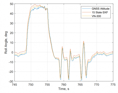

I did a comparison of our 15 state EKF, the VectorNav VN-300 (a high-end GNSS aided MEMS INS with GNSS yaw), and three GNSS receivers, which were used to measure attitude directly for their differential positions at a rate of 10 Hz. The results are attached, a little bias is present, but in general all 3 solutions match very well.
These information are priceless, thank you again.
