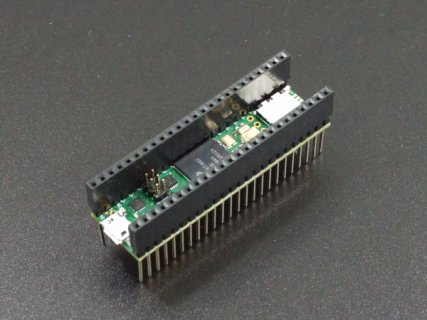

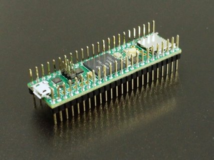

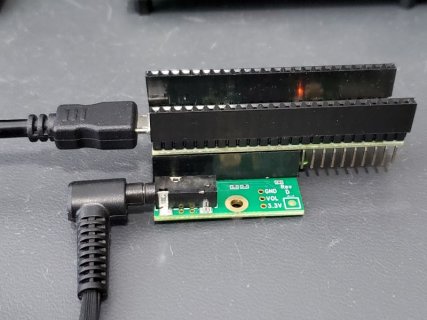

Michael I get customization requests frequently, so usually not a problem to build variations of the standard products like to add the memory chips but leave headers loose. In that case, just order the standard product and make the comment in the cart to leave the headers loose or drop me an email.
I also get requests to use double headers for logic analyzer hookups or some kind of stacking headers. For stacking headers, I use the extra tall stacking headers that have square pins instead of the not-so-great flat bladed Arduino versions and cut them down to 24-pin to fit. The pins are also extra long and can be cut down in length so assemblies sit flush if needed, otherwise they sit proud by about 3/16". Doesn't make for the shortest assembly, but the connections are solid.
Here are a couple of examples:
Teensy 4.1 with stacking header.jpgTeensy 4.1 with Double Header.JPGTeensy 4.1 and Audio Board Stack.jpgTeensy 4.1 and Audio Board Stack 2.jpg

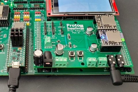

BTW, thanks for the tip about the DFPlayers when I ran into a problem when using Uncanny Eyes with the Teensy audio library.
Sourced some straight from the original mfr and created an adapter board that mounts 2 of them for a Zombie operation game for my wife's work. I am using 2 so that I can have eerie background music or loud scares from behind the user while also having various zombie sounds coming from the game itself. Board also connects 2 uncanny eyes LCDs (round LCDs inbound), a string of addressable LEDs for lighting effects, PIR motion sensor input to automatically activate/deactivate the game and tweezer vibration motor hookup. Now I just need to find the time to actually complete the game before Halloween!
It might be helpful to list as options the various ways things can be configured, and of course pictures can help.
When I'm doing breadboarding, etc. I tend to prefer have the Teensy with female stacking headers for each of the sides, plus 5 pin female headers for the row of pins next to the SD card, and for USB host. Unfortunately, the placement of the ethernet header is a problem. It is hard to use the ethernet pins along with female stacking headers, unless you make a special 2x3 2mm pitch header cable with one side shaved off.
Or possibly solder a short cable to the pins that then has the 2x3 pins to hook up the ethernet stuff. The same might work for USB host as well. Of course the trouble with soldering cables to boards, is eventually the cable may work its way to being unsoldered.
In my last order, in fact I was thinking I should have a Teensy with the ethernet pins, but that being said, I've never used the ethernet support.....
In terms of mounting the audio shield, with a Teensy 4.1 with just male pins soldered in, as far as I can see, there are several options:
  • Solder the audio shield to a prototype board (or put male headers on one and female headers on the other board) where you have one more parallel row of pins, and solder the male pins on the prototype board to be in the next row. This way in a breadboard (or a prototype board with parallel rows of headers), the audio shield connects on the pins outside of the Teensy.
  • Put female headers or female stacking headers on the audio shield and mount it underneath the teensy. If you are using a breadboard or prototype board, you could put the 24 pin stacking headers on the audio shield, and just hope you don't get random short circuits from things hitting the exposed pins.
  • Put a prototype board between the teensy and audio shield. The prototype board would have 24 pins on each side, but the first 14 would be stacking headers, and the last 10 pins would be clipped. This allows you to make other connections to the teensy on the prototype board (such as for the 2 SPI displays for uncanny eyes).
  • Get a parallel prototype board (such as made by electrocookie), and just connect the 28 wires between the two sides. IIRC, there are issues if the LRCLK or BCLK pin wire is too long, and it may or may not be an issue if you extend the teensy to another board.
  • Use some other audio output such as S/PDIF.
You are welcome.
Yes, part of my motivation was to start re-enabling sounds to the uncanny eyes (which I had briefly done with the Teensy 3.5/3.6). Your original query prompted me to see what the issue with the audio processing is. With my example handling mono sounds from memory, I didn't see choppiness in playing the audio, but as I said there might be dead space where it can't start the next recording until the eyes code finishes on whole pass. However, if you are reading from a SD card, it might have issues with latency.
