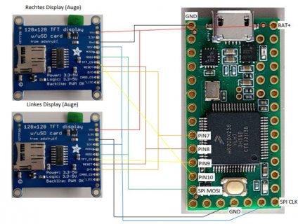

I'm new here in the forum and come from Germany. I've been building decorations and props for Halloween for a few years now.
Two or three years ago I installed the uncanny eyes in a skeleton using a Teensy 3.2. Unfortunately, this microcontroller is no longer available, so I hastily ordered a teensy 4.0 after reading that it's possible to create the eyes with it also.
I need it for a new project.
I'm smarter now and should probably have ordered a Teensy 4.1 instead. However, soldering is not a problem for me, if that is the only difference from the 4.1.
My question now would be, whether anyone has a picture of the circuit diagram for the screens with the Teensy 4.0. I have the following screens to choose from:
1,54" without CS
1,54"
1,67" without CS
1,67"
Are they connected to the Teensy 4.0 in the same way as the 1.44" TFT screens to the 3.2? I read about additional wires that have to be soldered to the teensy 4.0. Where does this have to be done?
I primarily only need the eyes without any interaction from outside. I read that sound should also be implemented or the ability to change eyes. Although I didn't understand what the sound was supposed to be for.
It could be, that I make the skull (the new project) talk, but I would then do that separately using a Pi Pico.
Must the same libraries integrated for the TFT (ST7789) on the Teensy 4.0 as on the 3.2 (Adafruit_GFX, Adafruit_BusIO, Adafruit-ZeroDMA and Adafruit_ST7789 instead of Adafruit_ST7735)?
I would be happy if you could help me with my eyes.
Greetings
Peer

if you look at Chris' code (in config) you see:
#ifdef USE_GC9A01A
GC9A01A_Config eyeInfo[] = {
    // CS  DC MOSI SCK RST ROT MIRROR USE_FB ASYNC
       {0,  2, 26, 27, 3,  0, true,  true, true}, // Left display
       {10, 9, 11, 13, 8,  0, false, true, true}, // Right display
#elif defined USE_ST7789
ST7789_Config eyeInfo[] = {
    {  -1,  2, 26,   27, 3,  0, true,  true, true}, // Left display
    {  -1,  9, 11,   13, 8,  0, false, true, true}, // Right display

The first thing I tried to do was to draw the wiring between the two TFT's and the teensy by following the pin design from Chris's code.
Unfortunately I didn't understand where the CS connections from the TFT's are connected to the teensy.
Or does the "-1" in the code have a different meaning and the wiring is already finished - as shown above?
In the official pin-out, pin 10 is CS.
I have for now put both CS connections on pin 10 and hope this is correct (dashed line)?
Another CS port seams to be on the back of the teensy 4.0 (pin 36).
Each display's CS pin should connect to a separate pin, and then in config.h you edit the code to list that pin. If the device doesn't have a CS pin, then you would put -1 for the CS pin. Some of the square 240x240 displays don't have CS pins.
The role of the CS pin is to enable the device when you have multiple devices on a SPI bus. I.e. on a shared bus, you have the 3 standard SPI pins that all devices use (MOSI, MISO, and SCK), and the CS pin is unique for each device. Essentially the displays are like an old fashioned party line in rural areas, where everybody is on the same line, and the CS pin says who the communications are meant for.
If you are curious, D/C tells the display whether the data being sent out is data or SPI command, and RST resets the display.
My personal setup is:
  • Display #1, MOSI = 26, SCK = 27, CS = 0, D/C = 24, RST = 25
  • Display #2, MOSI = 11, SCK = 13, CS = 22, D/C = 9, RST = 10
In looking at this, I should have reversed the order of the displays, so if you have only one eye, it uses the pins you can get to easily on the Teensy 4.0. Maybe I will reverse now that I looked at the code again.
For Teensy 4.x processors, it doesn't matter what digital pin you use for CS. The CS, D/C, and RST pins have to be unique for each device.
For Teensy 3.x processors using the 128x128 displays there several special CS pins that if you select the appropriate pin for CS and D/C it will allow you to speed up the display, and you use the same MOSI/SCK for both displays.
If you have a Teensy 3.x, this post highlights these special CS and D/C pins: https://forum.pjrc.com/threads/33014-SPI-Chip-Selects-(Teensy-3-1-vs-3-2)?p=96072#post96072. There are 9 special CS pins, but you can only pick certain combinations.
The optimization requires both CS and D/C to have these special SPI pins. On the Teensy 4.0, there is only one special CS pin (10) for the first SPI bus, and one special CS pin (0) for the second SPI display. The Teensy 4.1 added 2 more special pins for the first SPI bus (36, 37) and 1 more special pin for the second SPI bus (38).
As far as I know, none of the libraries use these special pins in the Teensy 4.x. In the original Uncanny Eyes code, they only used the libraries to set up the displays, and the Uncanny Eyes code talked directly to the displays. In the newer code for the Teensy 4.x, all of the special code that talked directly to the device was removed, and the code now uses the libraries to talk to the device. The libraries have some options to speed things up such as using DMA and secondary frame buffers.
I tend to set up Teensys like tinker toys (tm), in that I try to set up pin assignments, so that I can mix and match different things. I also setup a common wiring for displays, so that I can make a cable from the display that has the pins laid out in a standard configuration, so that I can easily switch between 128x128 OLED, 128x128 TFT, 240x240 square, and 240x240 round displays, even though the order of the pins on each display is different.

Hello MichaelMeissner,
thank you very much for your detailed answers.
I have now redrawn the wiring.
Are the connections correct now?
If the wiring is OK, I would turn my attention to the software.
However, there are still a few questions for me.
They look correct, with the proviso I've never used the 3rd SPI bus that is setup for wiring a SD card.
I usually connect the BL pin to 3.3v. In theory, it should handle not being connected, but I figure it is better to be safe.
