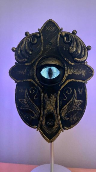

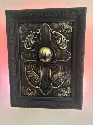

my Halloween-project: picture frame hanging on the wall... as an inspiration for more projects... it features sound (music and speech), LED-animations, animatronic-lid, ultrasonic distance sensor, person sensor, light sensor and acoustic sensor.

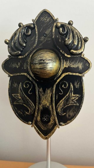

I did it again, this time as an elevated artifact with the same technical features
(I don't like the stand yet. It doesn't have a Halloween design, I still have to
redecorate it to the right style)....
...and thus one less "useful personal sensor" ;-)
I would like to implement two more ideas: a book and a crystal ball (fortune telling ball),
each with an eye, of course.
