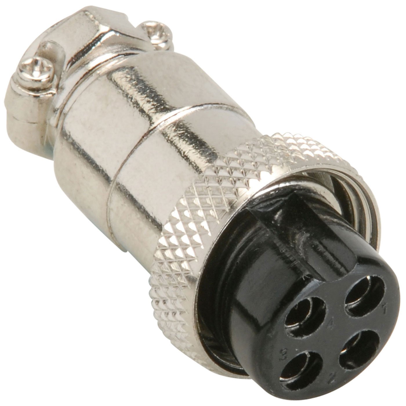

Any chance the 4 pin connector could be plugged in backwards by mistake? Or even if it has a shape that can't fully mate backwards, is it possible for the 12V to touch the other pins even briefly if someone tries to plug it in the wrong way?
Hi Paul!
The connector has a specific orientation that prevents it from being plugged in any other way. Check the image below:
Even so, after the first Teensy was damaged, I took extra care to plug and unplug the connector the right way and without jiggling. The new Teensy 4.0 still suffered the same issue :(

Does the connector have a design that ensures the ground pins mate first?
Generally when hot plugging you want ground to connect first then power and only then the signals.
If power and your data signals somehow connect before the ground it can look like a high impedance -12V source on the data pins (I've blown up PC USB ports in the past due to something similar).
Even if everything connects at the same time then it will take a short while for the voltage out of the regulator to come up to the correct level, during that time you'll in effect be trying to power the teensy through the serial lines.
Try adding a series resistor (100 ohms or so) on the data lines followed by some clamping diodes (i.e. a bat54-s between GND, signal and 3.3V)
No, it doesn't. Most of the times, all of them will connect the same time. Depending on the inclination of the plug or if any of the pins are loose, any of them could connect first than the other.
