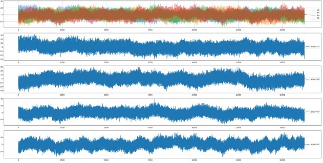

Ok all I did a redesign of the example. I believe this is what @Aaron Z is really trying to do.
Now if there is no connections between input and output nothing is seen in the fft plot.
But once I connect Line in with line out
Now no clue how to apply a window function in the python example. If someone wants to mod the example code will be happy to try it.

Thank you for your reply!
I tried your sketch, but sometimes I would have errors recording data, then I can't plot FFT. I think the reason might be "delayMicroseconds(50)", so what is the purpose for using this here? But those errors only occurred occasionally, sometimes I could plot the FFT. You mentioned you saw nothing on fft when nothing is connected to the input and output. Is this what you have (picture below)?
There's nothing on the FFT, which actually makes sense, since no sensors are connected to the input and output.
But when I connect both sensors to the board, just like the setup I posted, I still got this same FFT plot with nothing on it. I think it doesn't really make sense here cuz I suppose some signals(waves) or noise should show up. And also i suppose some signals should come from the sensor(receiver) on line_in.
When I delete "delayMicroseconds(50)", I could then see the peak at 10kHz, which is just what we were seeing before. Even when I disconnected both sensors, it still shows the same FFT with this peak, which means the signal on line_out is still leaking to line_in.
So, not sure if your sketch could solve my issue, and I'm little confused about "delayMicroseconds(50)" here.

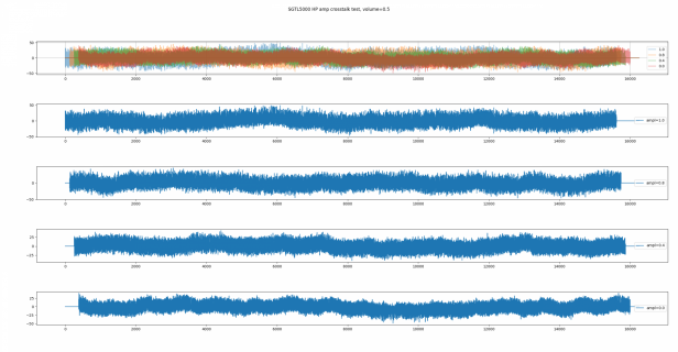

When running your sketch with read_serial and the ploting sketch I ran into the same issue but more often than not it the plot sketch was erroring out on reading the csv data. So I change the baud rate in the read serial sketch to 2000000 and added the delay on the output to get the data recorded more reliably - I am on a windows 11 pc. So if its working better for you without the delay then thats ok. For me I was having issues.
yep

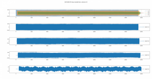

Been playing a bit more and cant figure out how to record and play at the same - however, I you just use the on board mic with no output and play some frequencies on the PC from youtube:
1khz:
2600 hz
5000hz:
probably have to remove DC level and use a window function to clean up real time signal.
1khz:
2600 hz
5000hz:

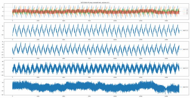

Think I found the solution but not an explanation of why. Check out this post: Audio lineIn reading data from SDplay output without any connections.
Basically comment out the following line:
  //sgtl5000_1.volume(1);
in your original sketch and then it starts working the way you want it work. I just gave it a try and it seems to work. If I hook up linein to lineout I am seeing the waveform, if I disconnect them the waveform goes away.
Let me know if it works for you.

An interesting problem. I did pull out my old t3.6 + audio board and did some testing.
It seems there is quite a significant crosstalk between the headphone amp and the ADC.
This is my test program, slightly modified version of the posted test sketch:
C++:

It waits for a signal from the python script (char 'S') to start gathering the ADC data into a buffer, (128 audio data blocks). Once filled, it prints it via Serial.
I've set the headphone volume to 0.5f, which is a normally used value. Each test step changes the amplitude of the generated 10kHz sin from 1.0 to 0.0.
Before getting into FFTs i wanted to see what the source ADC signal looks like. Here is a plot, this is the case where the Line inputs are floating:
And this is in more real world scenario, were the inputs will be either shorted to GND (via jack contact if nothing is plugged in) or driven from a buffer:

More tests:
i've switched to a 100Hz square wave, as it will be better seen on the plots and harder to filter out.
Interestingly, after disabling the HP amp power, i'm still getting the crosstalk - this means it happens between the DAC and the ADC, too.

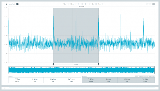

I have desoldered the ferrite bead and fed the analog 3.3V from the Nordic PPK2.
The 100Hz square wave edges are clearly seen on the current draw plot as peaks:
And in the ADC signal:
The crosstalk is clearly caused by the current draw peaks, resulting in a voltage drops on the analog supply rail (= also ADC reference).
Next step: supply the analog 3.3V from a linear bench PSU - got the same crosstalk results. This is still with a 10uF cap soldered ontop of the default 0603 2.2uF.
Only after adding a 100uF low ESR cap across the analog 3.3V rail the peaks are gone:
Headphone amp was disabled in the above test. After enabling it with volume = 0.5 we get this:
All the above tests were made with ADC Line inputs shorted to GND.
The results were the same as with bench supply (which has a series shunt resistor) when using an LF33CV voltage regulator and two 100uF decoupling caps.
